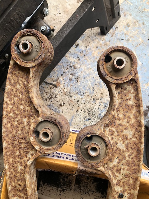

I took photos today of removing rubber bushes from my front radius arms for the buggy build, but didn't include them in the build thread, but I thought I might as well put them up as it may help someone searching?...

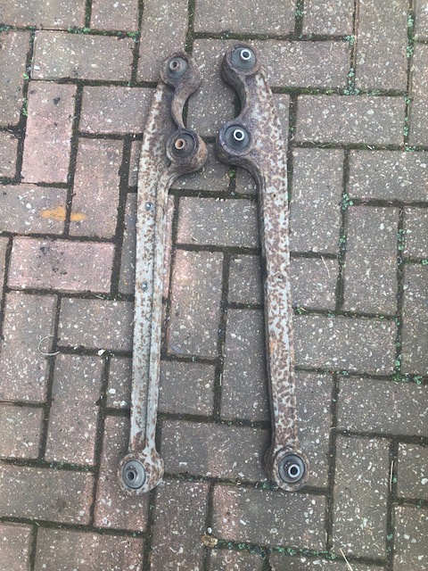

Ok, front radius arms off -
With a decent sharp drill bit (I used a 12mm) drill through the rubber on each bush -

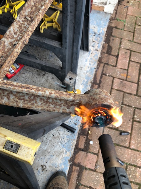

And then heat the steel insert with a blow torch, we're not aiming to burn the rubber, more to seperate the insert from the bush, so aim the cone of the flame into the insert sleeve on each side for about a minute...

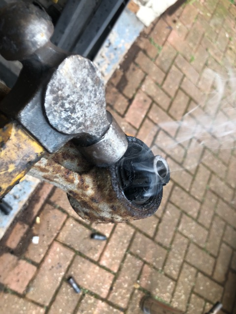

Then quickly, while it's still hot, give the insert a stout blow with a hammer so that it pops through the bush -

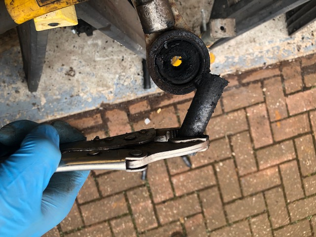

And tjem turn the arm over and grab the insert with a pair of mole grips and wrestle it out - again whilst it's still hot

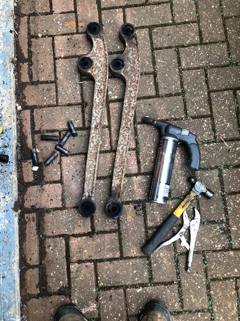

So we end up with -

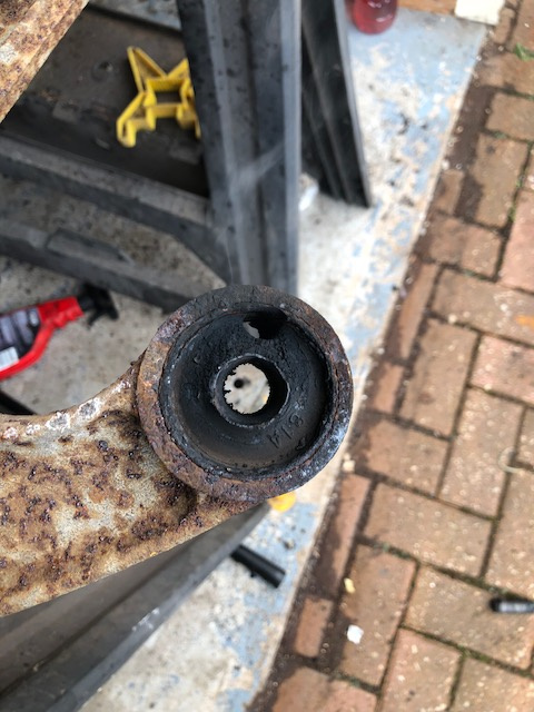

So weve now got a couple of holes to work with -

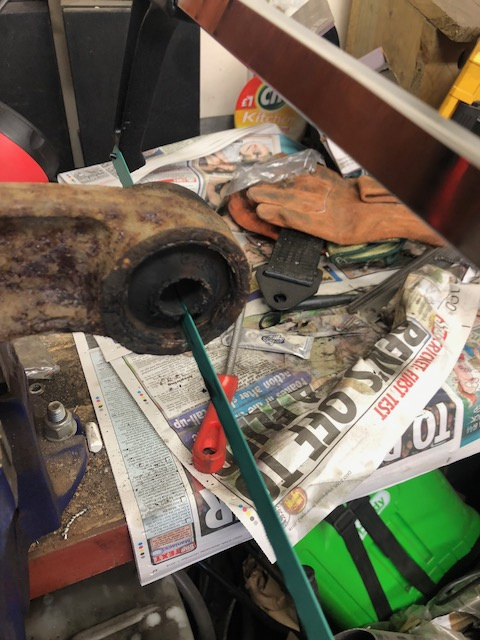

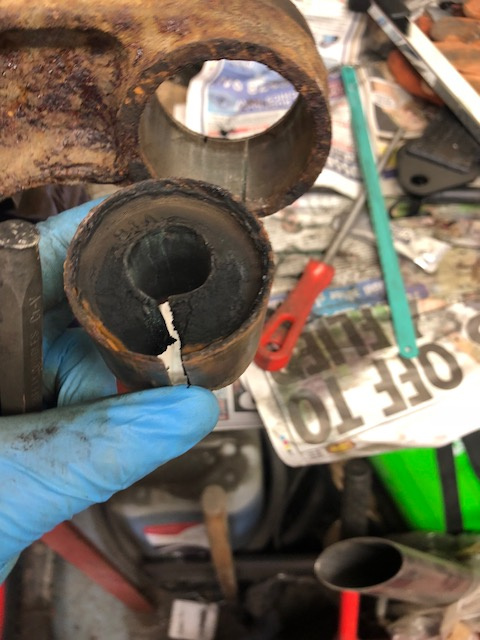

Now we can move to a vice and insert a hacksaw blade through the big hole where the insert was -
We can then cut the sleeve and knock the casing out

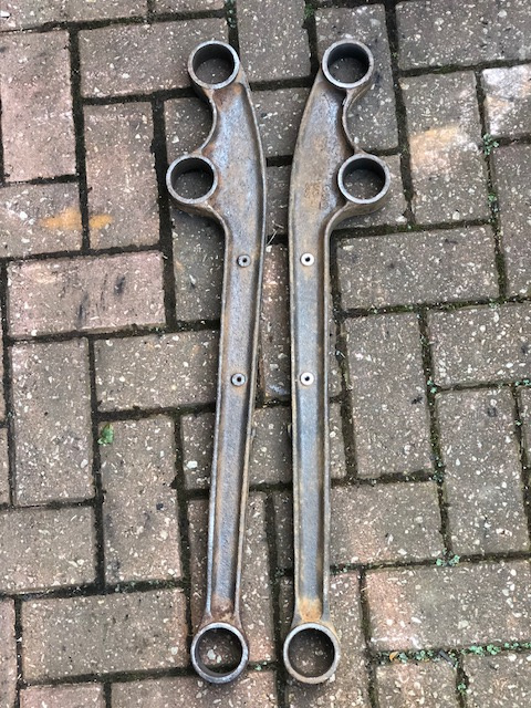

Repeat another five times and we get -
Wire brushed and ready for painting and new bushes....

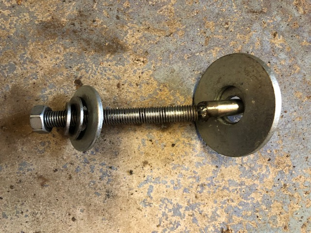

This is my puller -
Again on the cheap! On the day I needed it I couldn't find a bolt long enough, didn't want to rush out and source some threaded bar so I welded two bolts together :lol:
