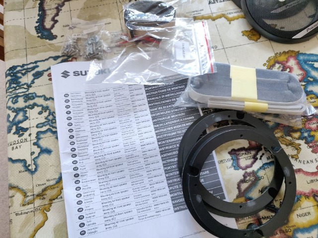

Front speaker upgrade bracket kit: Suzuki Part # 990E0-78R32-000

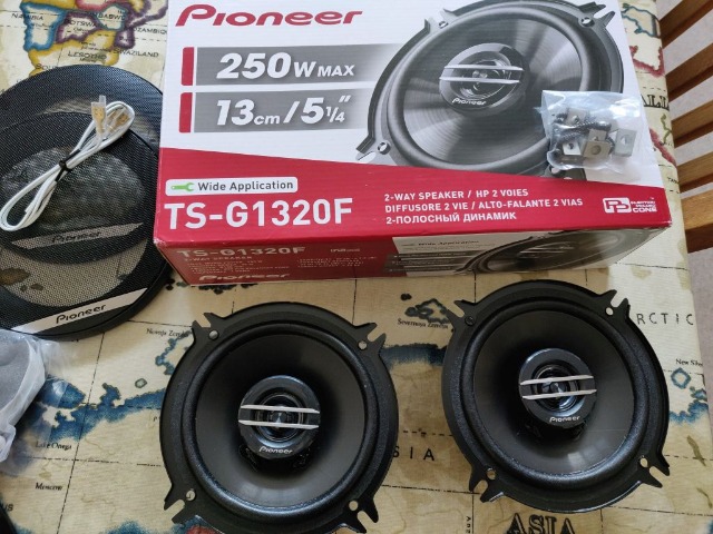

Suitable 13cm front speakers
While the 10cm front speakers in the Gen4 are surprisingly adequate, I'm always on the lookout for fun things to add to the car, so I decided to upgrade them!
Suzuki offer a bracket kit to allow 13cm speakers to be fitted (part # 990E0-78R32-000) and it's available from the BigJimny.com shop, thanks Martin!
The bracket kit includes all the parts needed for installation, however you need to source your own speakers. I went for the same speakers that I'd previously fitted in the back of the car, Pioneer TS-G1320F, which are a nice cheap (£20ish) option.

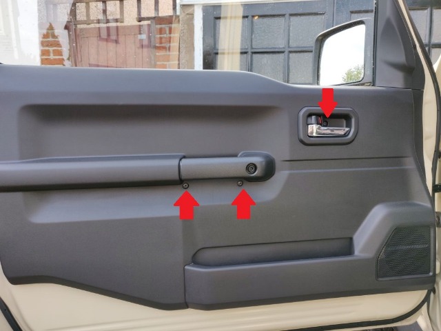

The only tricky part of the upgrade is pulling the door trim off. Always a bit nerve wracking, but once you know where the fixing points are, straightforward. First remove the two Philips screws below the door handle and one screw in the door release recess, indicated in the picture below.

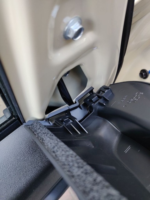

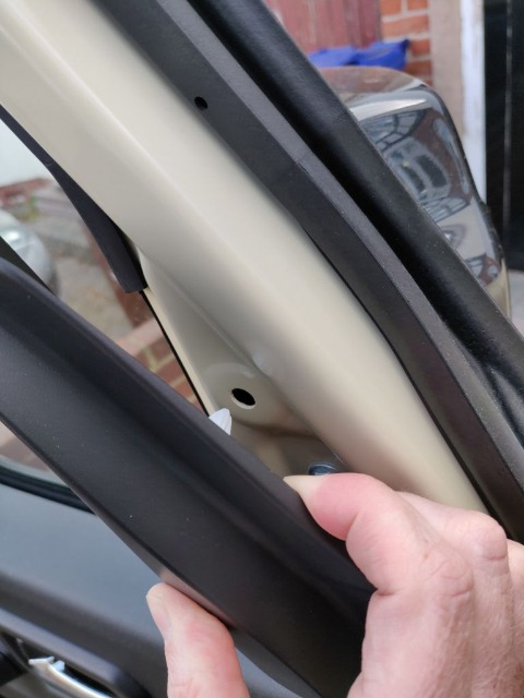

Next, remove the trim directly above the door panel by pulling from the top leading edge to release the single white clip and then pull gently towards you and upwards to release the latches at the bottom connecting it to the door panel.

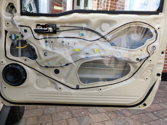

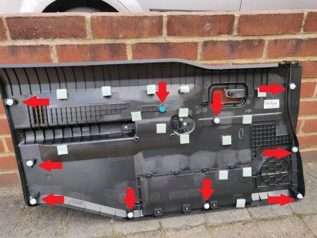

The door panel is secured with ten clips, nine white and one cyan (the cyan one seems to be more robust and more likely to detach from the panel and remain in the door) positions indicated below.
Starting from the bottom leading edge of the door below the speaker grill, pull the trim away from the door panel to release each clip in turn. Sharp tugs are more effective than gradual pressure.

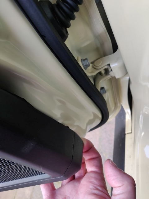

Once all clips have been released, gently unhook the top lip of the trim from the door panel.

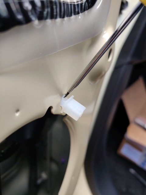

It's likely that some clips will have detached from the trim and still be located in the door, such as the cyan clip in the image below. Using pliers and a suitable flathead screwdriver, lever these out and replace them in the correct locations on the door trim, otherwise reinstalling the trim will be difficult.

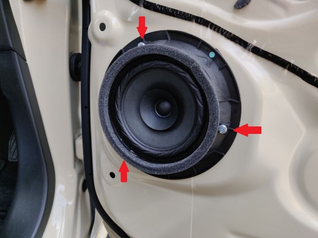

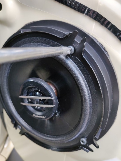

Using a Philips screwdriver, undo the three retaining screws holding the current speaker in place.

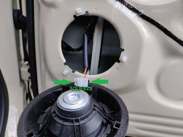

Pull the speaker away from the door and squeeze the wiring plug to remove from the socket.

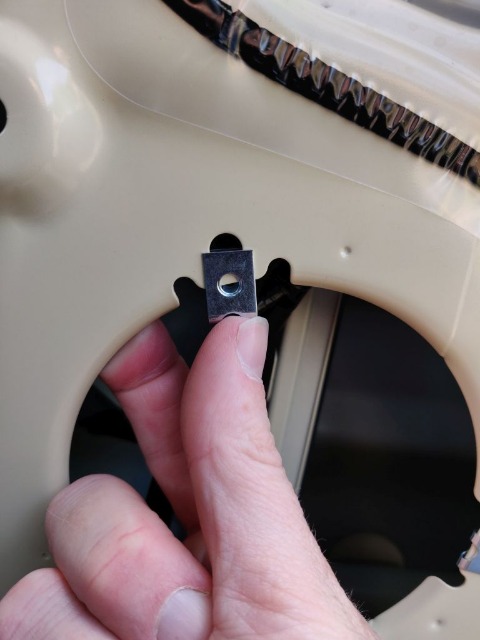

Push into place three metal clips, each will click into place over the existing hole in the door panel.

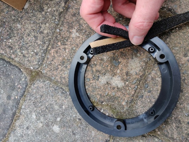

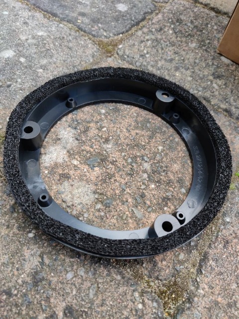

Using one half of the coarser, black foam supplied, line the face of the mounting ring that will sit against the door panel.

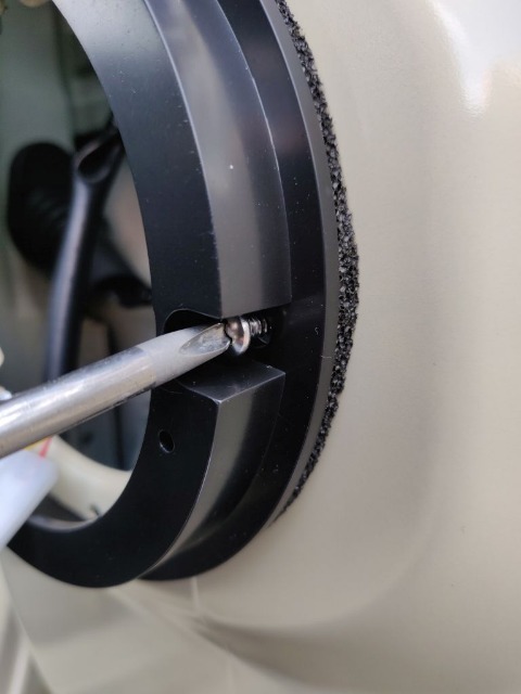

Screw the mounting ring into place using three of the self-tapping screws supplied with the mounting kit.

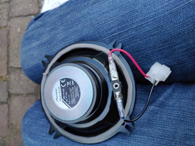

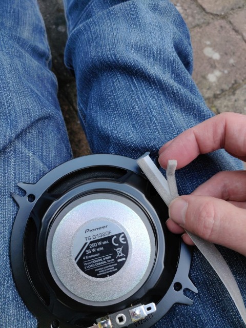

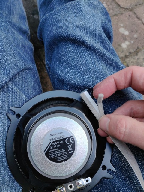

Apply one half of the thin grey foam to the rear of your new speaker, adjacent to the speaker cone. Then connect the supplied wiring harness to the speaker terminals.
Connect the wiring harness to the plug in the door panel and screw the speaker to the mounting ring, using self tapping screws that came with your chosen speaker.

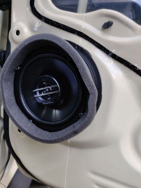

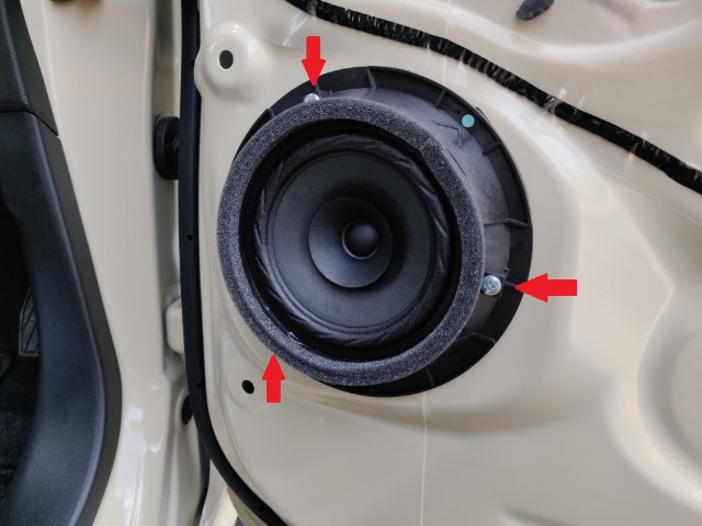

Apply half of the thicker grey foam around the front edge of the speaker body, taking care not to let it adhere to the speaker cone itself. Pinch the foam around the raised lip and make sure the foam is angled away from the centre of the speaker, so that it doesn't fold over the cone when the door trim is reinstalled.

Reinstall the three Philips screws in the door release recess (1) and below the door handle (2 & 3).
