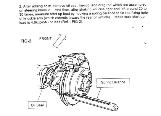

Suzuki don't specify any preload for the swivel bearings (kingpins), on a Landrover you shim them until it takes a specified force to start the hub turning.
However, in a desperate attempt to fix the wobble, Suzuki did put out a service bulletin to suggest banging shims on top of the upper bearing to increase the preload from "probably all-right, we machined it in when we made it" to a known figure
Notice the big dust seal has to be off.
I'd just pop the track rod end out of the arm and compare how much effort it takes to start the hub turning each side. If it is way to high, the car will wander as the steering can't centre itself as you go along.

21 Nov 2018 14:08 #197918
by facade
The big seal around the ball housing has to be taken off and left dangling for an accurate measurement (as in the picture), as it is the friction component that damps out the death wobble (or doesn't).
Just for comparing each side I wouldn't bother. If you can move it by blowing on it, I'd look at shimming it, if you need your feet on the chassis and arching your back to shift it I would look at measuring and fiddling with shims.
Probably when you seal was replaced because it had turned over, they simply undid the ring, pulled it back and refitted it.
Replied by facade on topic Re:Jimny following camber of the road
paradox1001 wrote:
How do you mean the dust seal has to be off?
