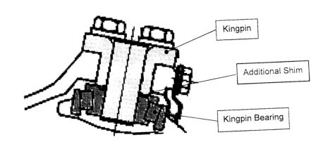

The shims fit over the top kingpin (usually) and are fitted from the outside after the hub is assembled, by removing the kingpin and slipping the shim over the pin part.
An old mechanics dodge was to put an annealed copper washer in there, the copper spreads out under the load when fitting and then work hardens to give a rather unscientific preload. You might find a thick hard copper washer in there.
The shop sell a kit of different shims to adjust that preload spot-on.
Before you dismantle the car, it might not be the hubs, but I can't think of anything else if the rest of the steering and suspension is in good order.

paradox1001 wrote: @ facade cheers for that I’ll give it a try
If one side has been fitted with shims and not the other
Will I have to take the whole thing apart to remove the shims or can it be done by just removing the king pins one at a time?
