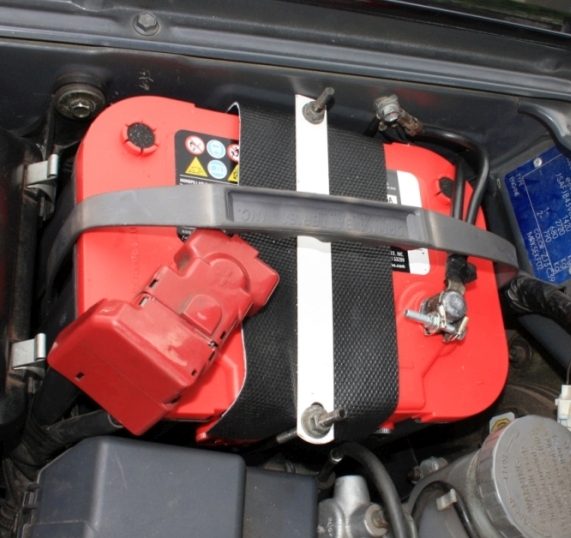

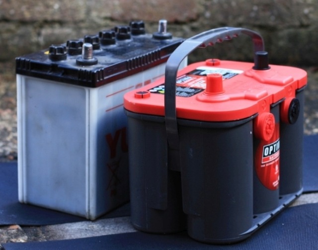

Hi
I swap my old Yuasa on red Optima three years ago (Optima Red Top Battery RTU 4.2 (8004-250).
If you need more details, please don't hesitate to contact me (r.borzecki@gazeta.pl).

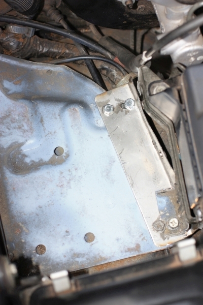

First we must make battery tray little wider. I didn't have welder, so I mount a piece of steel using M6 screws.
Second problem (if it does any matter?) is that fuse bracket has legs with different length, so one leg goes on, one under the new tray.
Third - you must exchange clamps on wires.
Fourth - we must cut air filter box as it touches Optima (not a big deal).
Cheers
