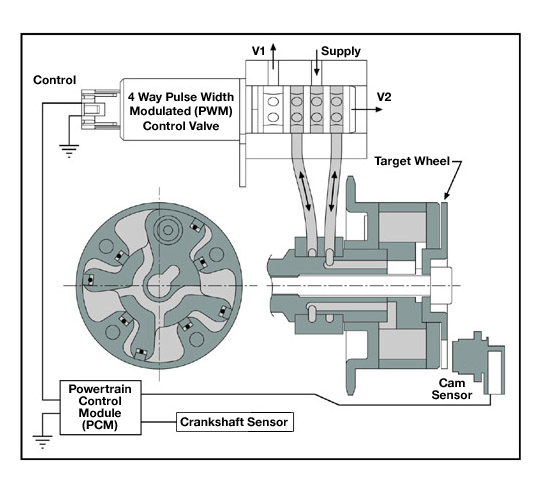

Checked heat shield. Still welded to the pipe in both ends and with the spring around it. No such sounds there. did not get to looking under valve cover yesterday as i was doing other stuff to the car. Did another listening run and still the same: No sounds when cold, but on load when warm. Google and other experts has revealed no real solution or alternative.
Looks like the VVT sprocket/wheel/actuator is a hydraulic device.(?)
Does anyone know how this item works?
Is there a solenoid valve or something i can check the function of?
Still got my M13 engine i can swap parts from.

The vvt is controlled by the solenoid valve located horizontally at the top front of the engine, below the water elbow pipe.
There are 2 oilways in the sprocket end of the inlet cam, fed from this valve.
The cam sprocket is loose and attached to a 3 chambered cylinder , and there is a 3 spoked impeller on the end of the cam that is inside this cylinder.
With no oil pressure the sprocket rotates until the impeller blades contact the chamber walls, and the cam then rotates retarded so the engine starts.
When there is oil pressure, the ecu requests a specific timing advance or retard, and moves the solenoid valve one way or the other, to allow more oil to get between the impeller blade and the chamber wall on one side, forcing the cam to move relative to the sprocket.
The solenoid is operated at a high frequency, and the impeller blades end up locked solid with oil on each side of the chamber (or the cam would shoot forwards as the lobe goes over the tappet)
This is the general idea, this is actually a Delphi system, but I believe the jimny is the same
I can't see that rattling tbh, unless there is a massive oil leak at the front of the cam, and I'm fairly sure the erratic cam timing would put the EML on.
