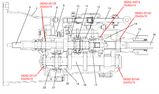

Found this which might hep anyone rebuilding. The pic shows bearing numbers and locations in a cutaway view:
