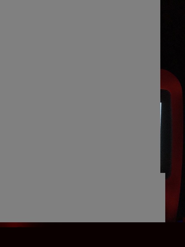

- Pendragon
20 Jan 2017 20:55 #177081
by Pendragon
Replied by Pendragon on topic Engine management light
Picture didn't come out too well....
Code reads: P0130 O2 sensor circuit, bank 1 sensor 1
