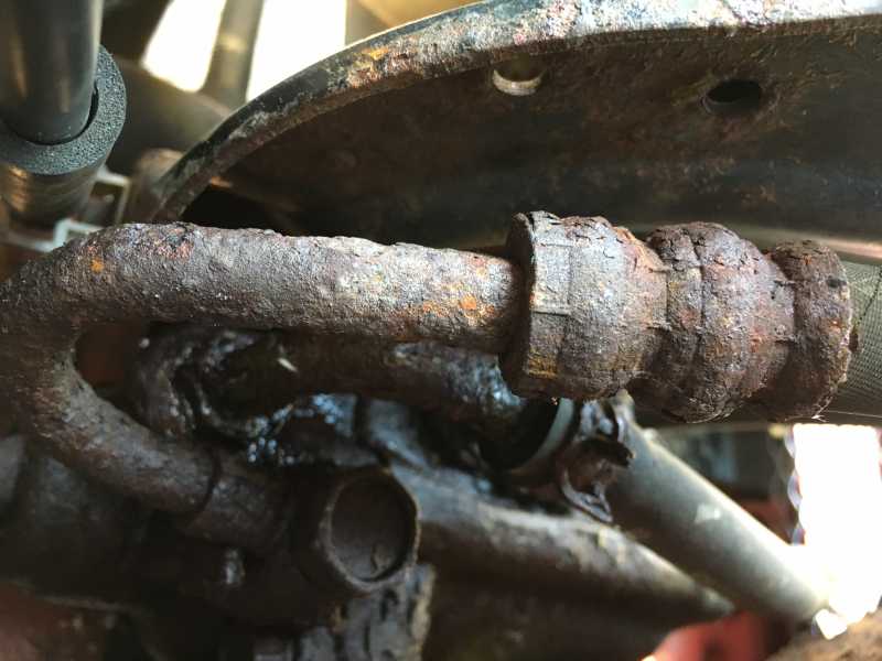

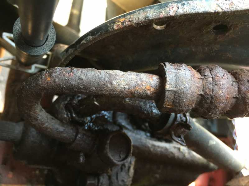

30 May 2016 11:50 - 30 May 2016 11:52 #167712
by The Dug
That's a coincidence, came on to ask about the exact same problem.
I don't really use the jimny much now - my dad takes it when he's walking my dog but even that's not too often now.
I'm a bit embarrassed at how good the OP's looks compared to mine :blush:
I'll give the crowfoot sockets a go bit I'm worried that the nuts with just crumble.............
Replied by The Dug on topic Power Steering Leak
Last edit: 30 May 2016 11:52 by The Dug. Reason: Forgot to insert photos
