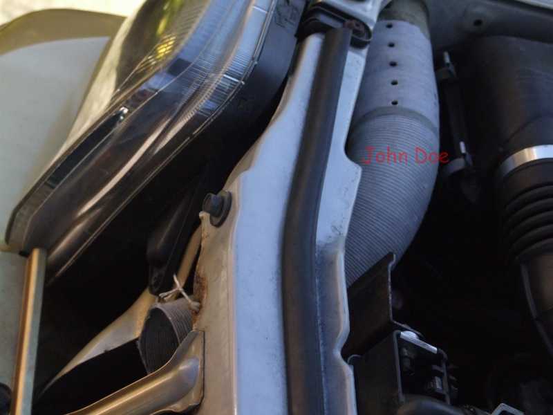

It is. Just front of the filter box.
Something like this. ;)

Looks like youve already extended the feed ;)

jonesyba420 wrote: Looks like youve already extended the feed ;)
Yup, ram air and fresh air. ;)

If your looking for performance gains the bigger the feed pipe the better (to a degree), the simpler route the better, add a decent performance filter hey presto youll have better results than a cone filter gulping in hot air from the engine bay.
