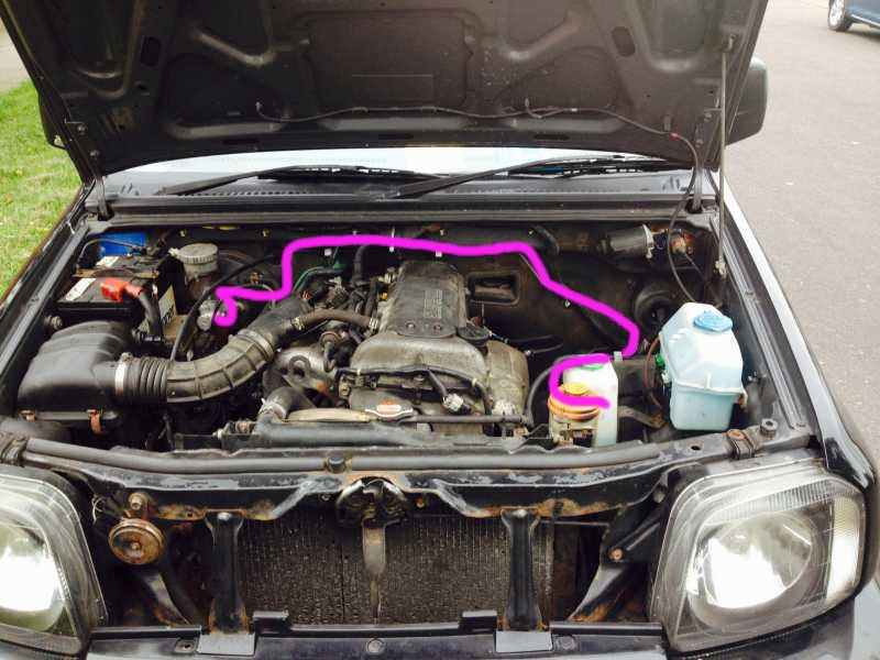

You haven't got the abs actuator.
If you trace the pipe I have highlighted in pink, it should go right from the master cylinder at the left, to the passenger front wheel at the right (rubber hose under wing), without passing through an actuator.

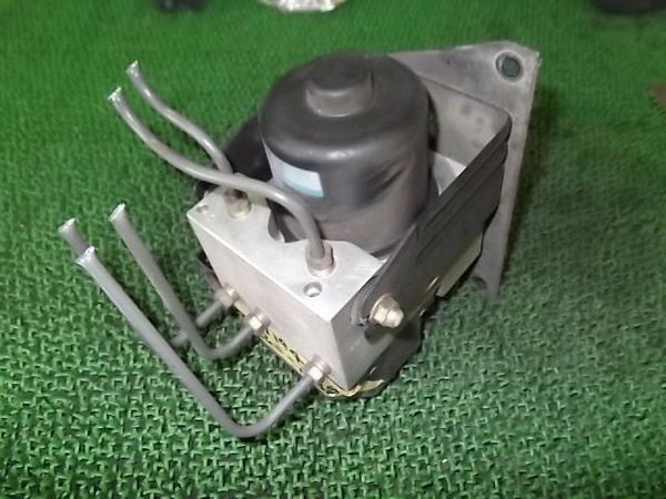

ABS actuator has 5 brake pipes and an electric motor.

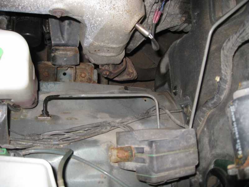

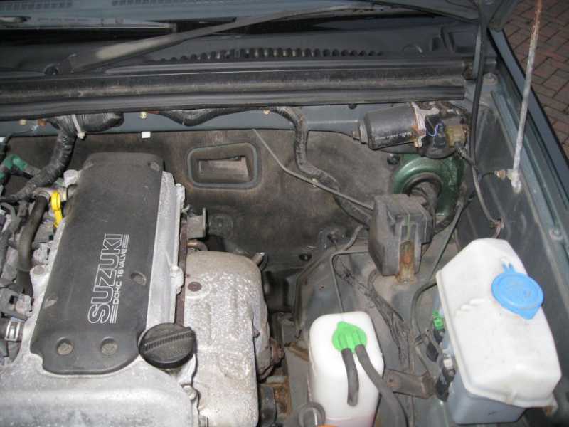

As you've shown me yours, I'll show you mine :dry:
black box is the alarm, fitted where the actuator would be
Pipe goes to front wheel
Pipe goes to master cylinder
The flash really brings the rust out
