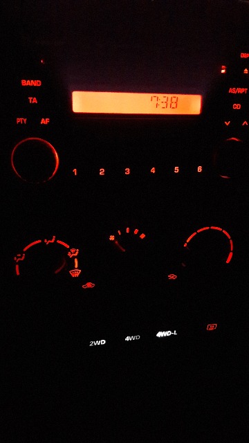

I changed my heater control bulbs today, it was a right ball ache.
I found the best way to swap them over was to remove the stereo so you can get access from above to the one on the right and twist it out.
However the one on the left was trickier to remove properly, so I pulled the actual bulb from the little black holder by moving the thin plastic fascia to expose it.
Halfords sell the bulbs separately from the holders , but on eBay there's green ones which look pretty tempting
Looks nice for now anyway

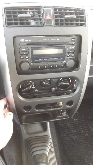

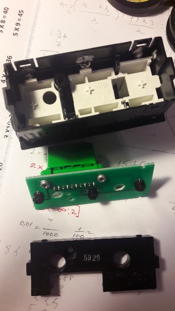

Ok so I finally had some time to change all the bulbs:
The AC light required a removal of the black background, the knobs to get to the bulb (the right one especially..)
The T5 leds fits perfectly, don't forget the tiny red rubber:

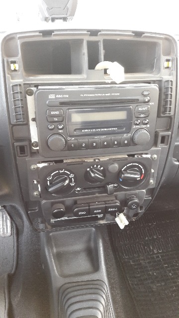

The 4WD switch also require a bulb change, I dont have time to wait for ebay so I just bought 2 T3 bulbs (we call them "rice bulb" here..)
Now I need to reassemble everything..
