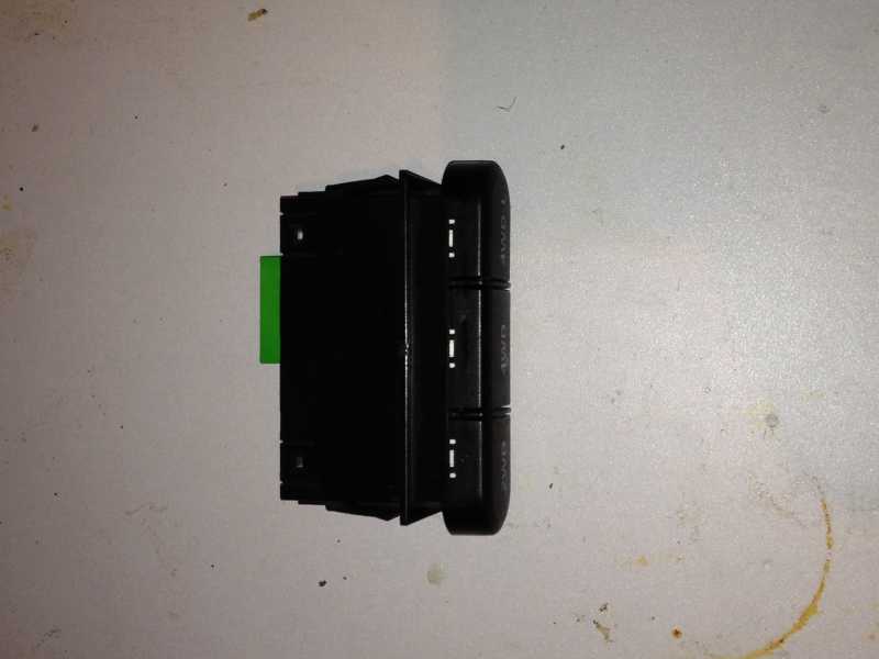

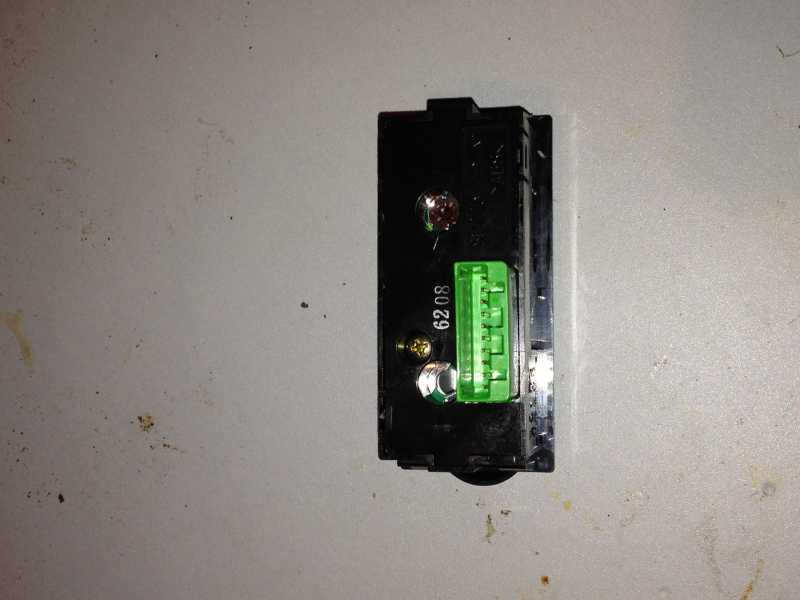

The switches out
Clips you push in, 2 on other side as well

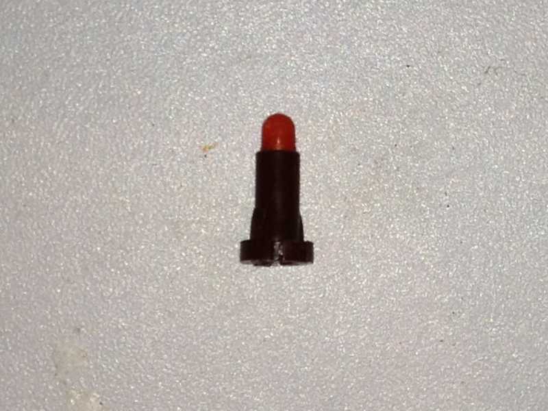

Where the bulbs are (1 out already)
The bulb, the red is actually a sleeve over a clear bulb.

andyf wrote:
The switches out
Super Andy,
That photo's,
I check it with my situation..
Hope and think it will be the same....
thanks a lot!

Think the bulbs are 15mm long so link I posted are too long.
  • andyf
18 Nov 2013 22:03 - 18 Nov 2013 22:06 #91984 by andyf
Replied by andyf on topic Change defect dashlights
Ok got it figured, you need to unwind the wires at the back and pull the old bulb out. Now, if you go to maplin and order bulb pg78k (red), fit it to the existing holder and twist the wires as they were originally and bobs your uncle. If you want you could go green, blue or yellow if you fancy.
