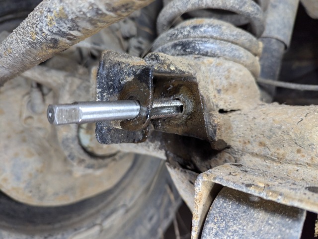

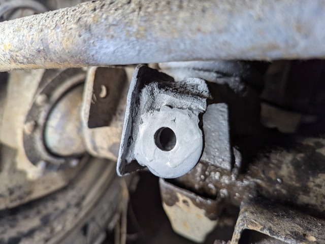

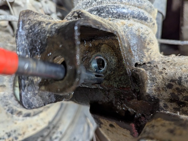

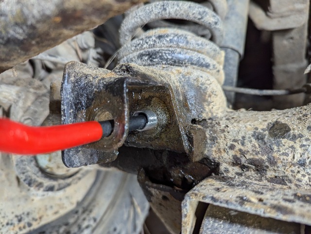

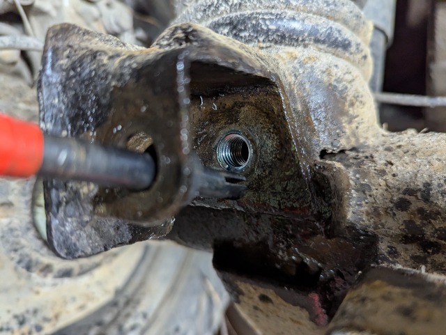

13 Dec 2024 21:00 - 13 Dec 2024 21:02 #258732
by njet
2003 Jimny, 3.5" lift on HD caster-corrected arms, 30" Coopers STT Pro, rear locked → build thread . Live updates on Instagram @moge.wszedzie .
Replied by njet on topic Re:Stripped the captive nut in my front panhard rod
I googled the issue and this 11yo thread was first. I though I will update it for anyone else looking.
My issue was as described by the OP: stripped thread in the captive nut + elongated hole at the front.
I first used the thread repair kit. 12.4mm drill (part of the kit) made a quick work of drilling the stripped nut out. Remember to use drilling oil, just in case.
The thread insert was M12x1.75 (also part of the kit) and it matched my bolt. Double check if it does in your case. Pictures may look mirrored to you all, but keep calm, it's continental Europe
Tips:
- using cutting oil
- when tapping, back off ans clean the tap regulaly. It's better to be slow here than break the tap
- the front hole is too small for the tap, I had to thread it as well just to get to the rear
- lock tide the thread insert
Once this was done next is the oval hole at the front. Without fixing it the problem would return ruining the effort in the back.
I found an oversized washer with M12 hole and cut two edges off of it to fit in front of the bracket.
To make sure the hole aligns with the tapped thread, I screw the screw in before tacking the washer in place.
Don't judge me on the welds, a battery in my mask decided to quit today and I was welding blind.
A quick test showed major improvement.
Overall took 3h to complete end to end.
Have fun!
