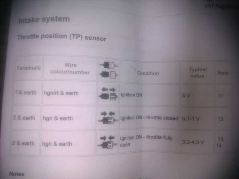

- Licksan
15 Nov 2012 21:19 #53383
by Licksan
Replied by Licksan on topic Throttle Switch/Sensor
That error code is for the TPS which is fitted to the Throttle Body.
The symptoms you describe are the same I experienced.
If you unplug the TPS it should run ok. The MIL light will stay on and fuel economy will suffer a little but stops you having to heel and toe to keep it running when braking for junctions!!
See this thread of mine for some info.
www.bigjimny.com/index.php/forum/7-jimny...tion-sensor-tps-m13a
