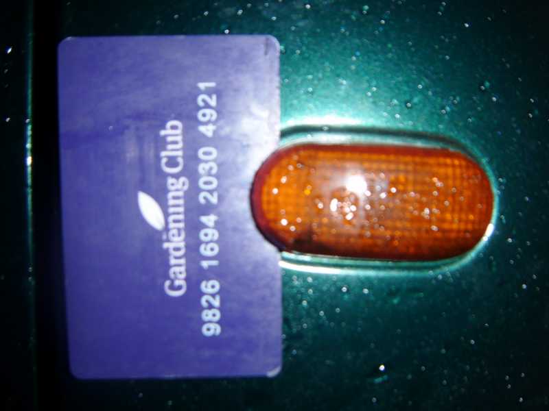

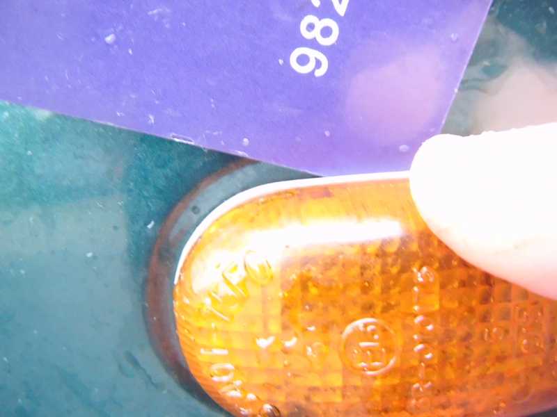

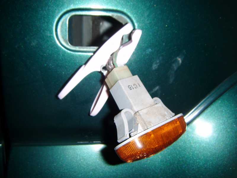

Steve you don't need to remove the inner wing just do as I've done in the photos with a plastic card.
Pull the top of the indicator unit with your thumb so you can get the corner of the plastic card between the wing and the indicator.
Now move it around to side, push the card into the indicator and it will pop out.

Cheers dirtydogz!
I have not got the unit sent to me yet but this will save loades of time, amazing!
i take it it is as simple to place it back in once its out ? i understand you just pull the connector out behind the grey unit and connect the connector to the new unit and then just press the unit back in place ?
Cheers for uploading the pics to, smashing help.

jimnyonhigh wrote: ... you just pull the connector out behind the grey unit and connect the connector to the new unit and then just press the unit back in place ?
quote]
Take care the 'plug lead' does not pull back inside the wing (this is bassed on my other car) wrap something around the plug as you disasemble ready to reasemble. ....

Christ thats a very good point!
Knowing me that is something i would not think about, i guess theres not much slack regarding the plug lead.
Cheers Tadpole
Cheers Tadpole
