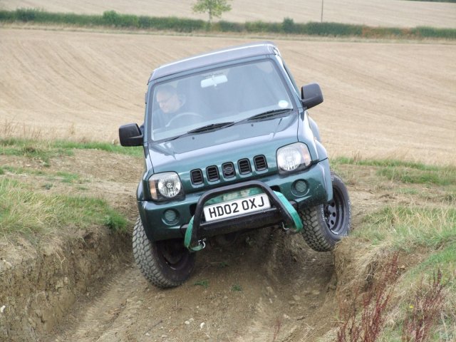

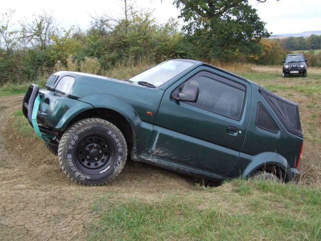

  • dirtydogz
09 Sep 2012 11:03 - 14 Sep 2012 22:09 #47827 by dirtydogz
Replied by dirtydogz on topic tyres
Hi Mudman.
This is my Jimny with just 1.5 spring spacers and 205/75/15 on 7x15 modulars at wagtail and it did not rub once here are some photos.
I now run a 2" Jimnybits lift with no rubbing so go for the 205/75/15 or 215/70/15
Hope this helps
DIRTYDOGZ
