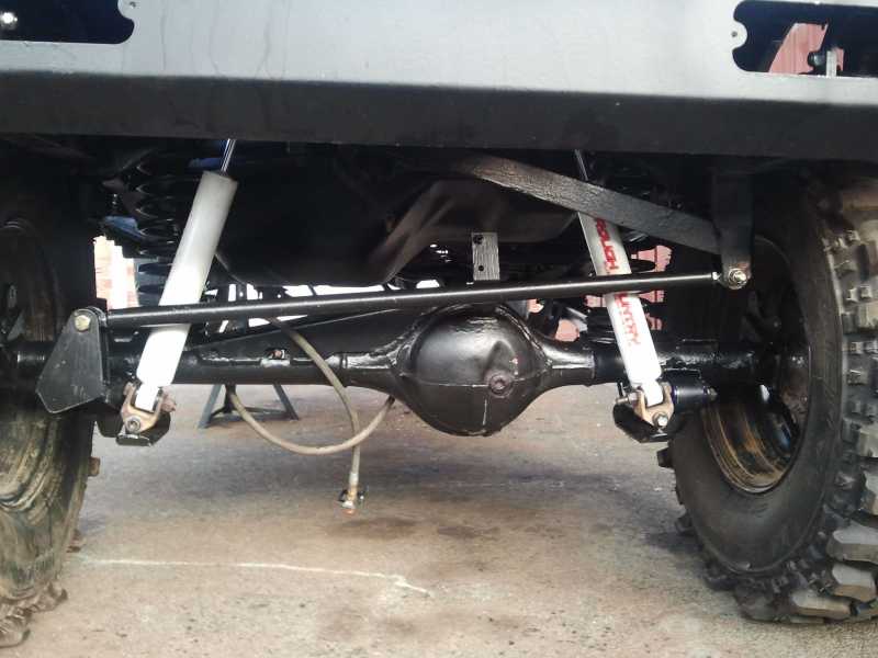

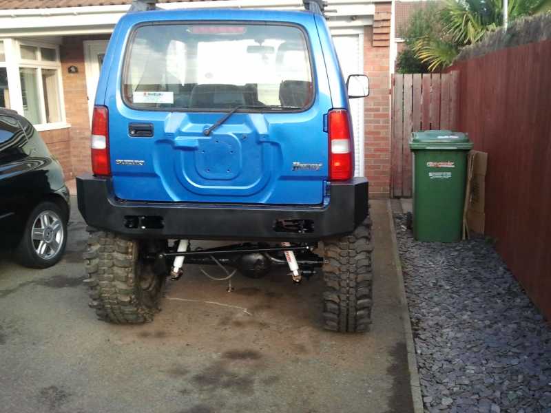

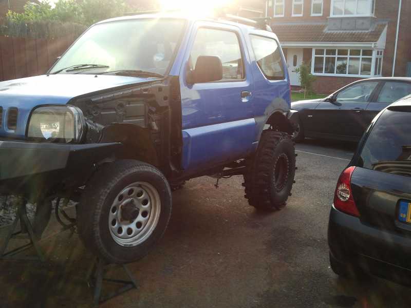

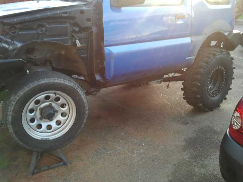

- Smoggy
03 Sep 2012 20:40 #47436
by Smoggy
Replied by Smoggy on topic Oops rear shock problem!
- reaper
03 Sep 2012 21:31 #47441
by reaper
Replied by reaper on topic Oops rear shock problem!
Nice !
Good to see it all went on ok ,and i can now see how you have the panhard brakets set ,in the earlyer ic they looks on the same plane as the shock
- Smoggy
03 Sep 2012 21:38 #47442
by Smoggy
yeah I can see that now Dale.
Only issue now is passenger tyre sticks out 10mm further than drivers. Am I over obssesing considering its only 10mm, could it be because its still on axle stands at the front, which I suspect could be at a slight difference in height?
- reaper
03 Sep 2012 21:40 - 03 Sep 2012 21:44 #47443
by reaper
I would guess its as you said before , it all needs to settle down
After you have done the front have a drive round then re-measure
