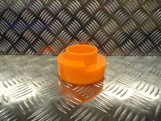

fitting spring spacer to cure the jimny lean help
01 Jul 2012 15:54 - 01 Jul 2012 15:54 #43315
by dirtydogz
2002 JLX Soft Top
Replied by dirtydogz on topic Re: fitting spring spacer to cure the jimny lean help
Steve most member fit one a 1.5" inch on the drivers side to stop the lean.
www.bits4vits.co.uk/store/jimny/spring-s...y-lean-/prod_43.html
2002 JLX Soft Top
Last edit: 01 Jul 2012 15:54 by dirtydogz.
- stevedumptruck63
01 Jul 2012 16:04 #43319
by stevedumptruck63
Replied by stevedumptruck63 on topic Re: fitting spring spacer to cure the jimny lean help
thanks for the quick reply,i better get one ordered. :evil:
01 Jul 2012 16:13 #43321
by dirtydogz
2002 JLX Soft Top
Your welcome mate we are here to help.
2002 JLX Soft Top
- Posts: 976
- Thank you received: 77
01 Jul 2012 17:48 #43330
by robs5230
standard jimny - for now
Replied by robs5230 on topic Re: fitting spring spacer to cure the jimny lean help
yeah thats the one from jimnybitz. before it was pissed corner to corner , up back left , down front right . worth getting new front lower shock bolts and bushes if needed . all go on at the same time.
