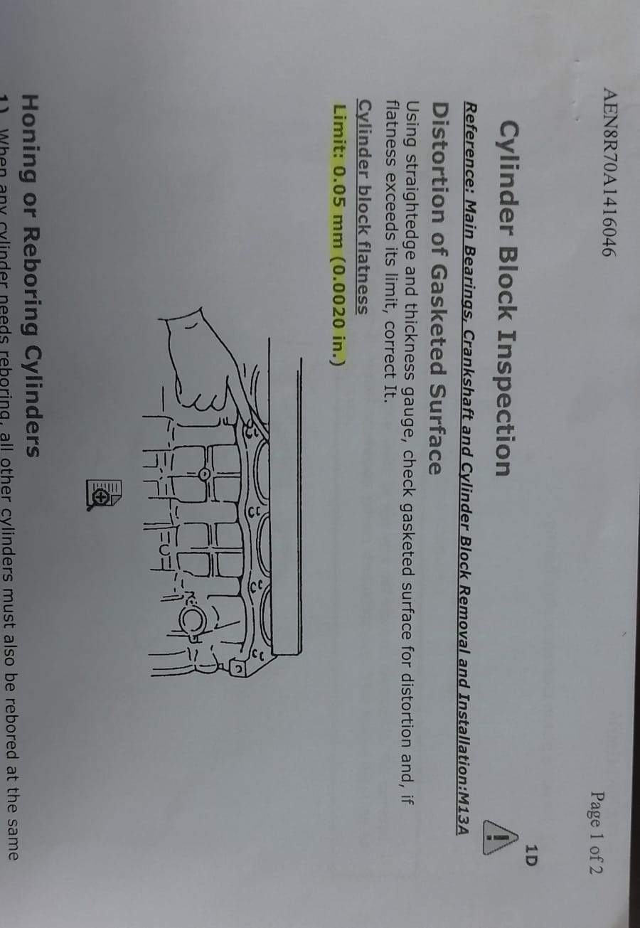

Hi everyone!
I am strugling for months with an engine JB43 rebuild with +0,50 original pistons.
The manual service (this one piece was given to me by Suzuki repretsentative) only describes how the maximum amount of flatness to be corrected: 0,05mm! He said Suzuki recomends to not accept more than this because integration of sensor signals could not work properly.
However, it did not inform the original size.
As the engine condtioning company did not measure it pre and pos service, I am in the dark and the Jimny is with high consumption and low power. We changed almost every sensor, and I know many other pieces could be involved, I just want to rule out this one.
Best Regards!
Best Regards!

That measurement is the flatness of the surface of the block, to ensure it seals correctly with the gasket and holds compression. It won't affect any sensors. A compression test will give you an indication if the gasket is sealing correctly.

I suppose that a measure of the block height, wich is not available in the service manual. The car mechanic performed compression test, he said it is ok. However, the fuel consumption increased nearly 40%, the power is reduced, and somotimes the car is sputtering.
