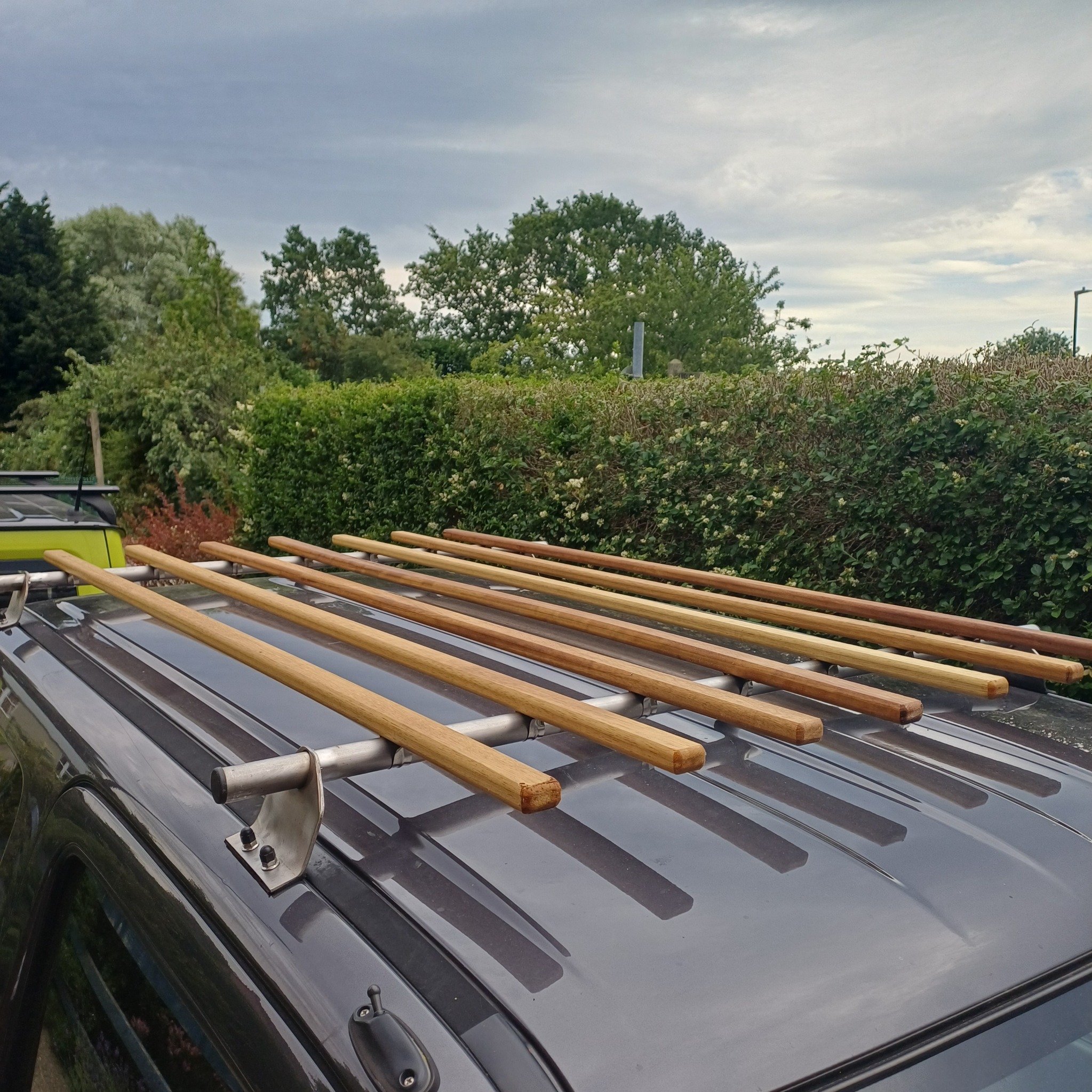

Just be aware that some of those flat racks can weigh almost all the roof carrying capacity on their own, as it's only 30kg. I made my own that weighs 5kg out of stainless steel and iroko wood.

23 Aug 2026 16:55 #265145
Replied by Lambert on topic Roof rack/awning recommendations
The following user(s) said Thank You: a.dutton@hotmail.com, jimnythesaint

23 Aug 2026 17:09 #265146
by jimnythesaint
Replied by jimnythesaint on topic Roof rack/awning recommendations
Looks great!
