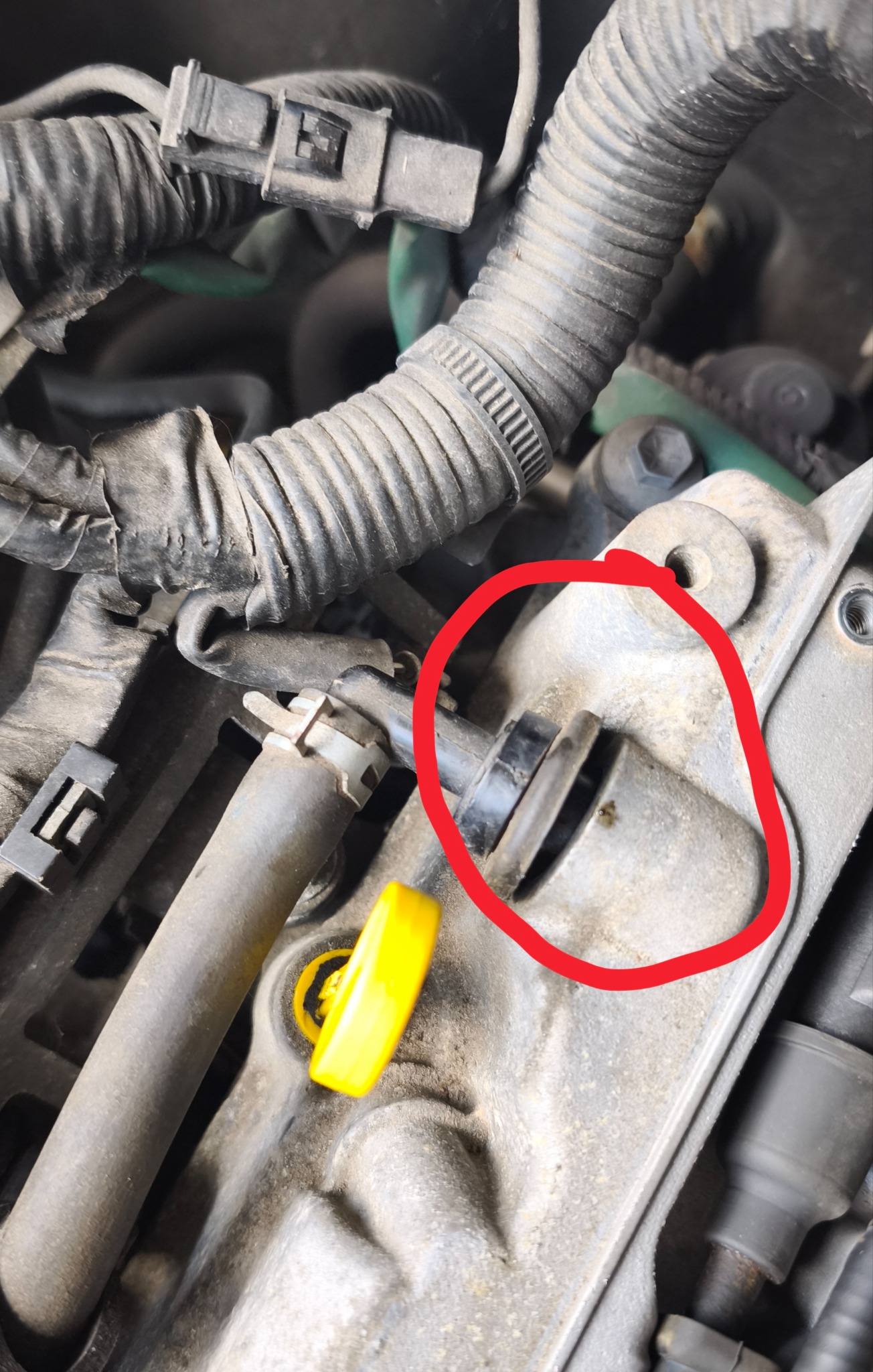

Hi all, can anyone on here help me. I've just noticed a loose rubber hose that enters the top of the engine (M13E DOHC)of my 04 reg Jimny
Can anyone tell me what it is?
It appears to have lost some kind of washer and is completely loose. Anyone got any ideas where I can get the missing part?

The black piece is the PCV valve and there is no "missing" part - the valve goes into a rubber seal which looks like it's loose - try pushing it into the valve cover and if it doesn't stay, replace it, it's probably gone hard.
Check the BigJimny online shop for a replacement.

Thanks for this. There's definately something missing though. the hole is bigger than the tube.

Thanks again for this. Looks like part of the rubber seal has gone. Thankfully, they've got them in store, so just ordered a new one. Cheers.
