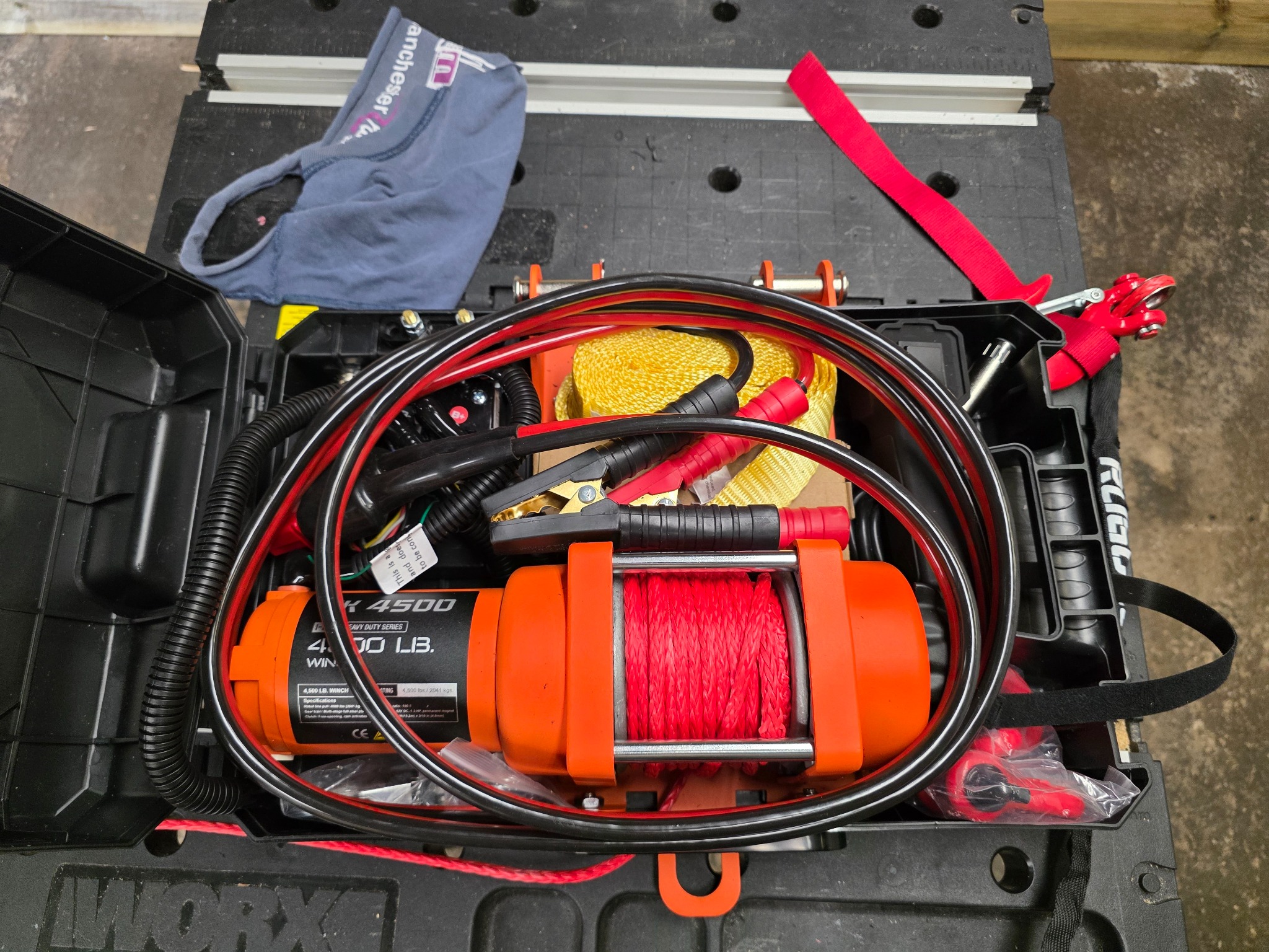

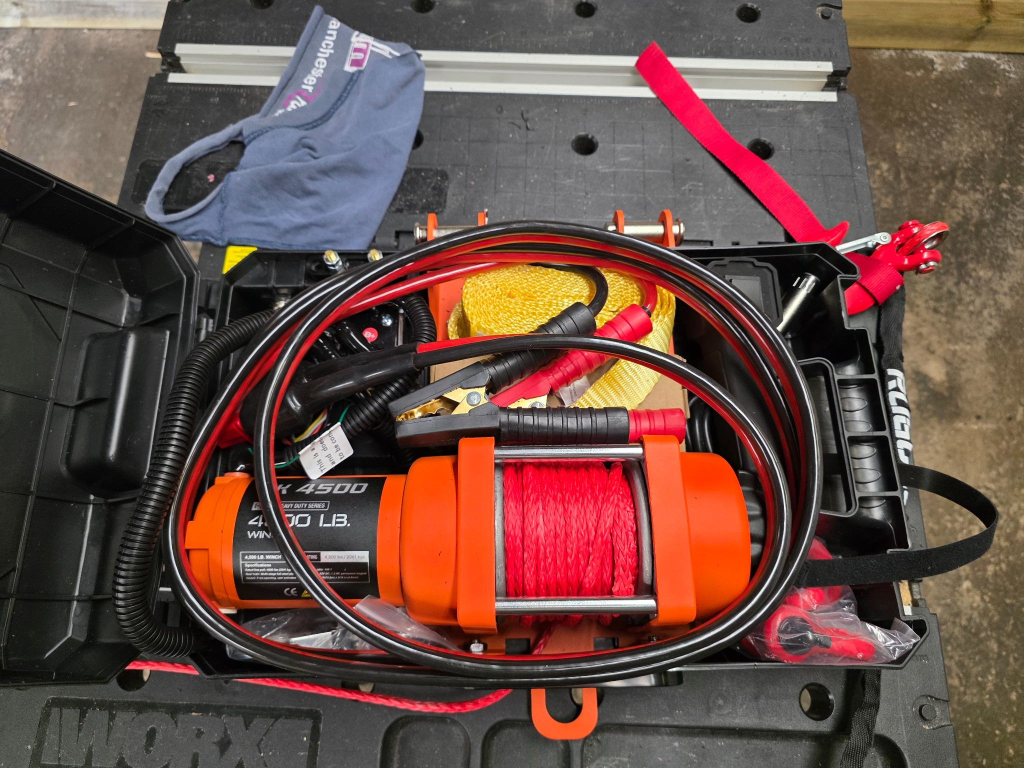

So, I went for the lazy and easy option of a portable winch in a box. Two options I found on the market, one by Warrior which I had seen before, and one from Rugcel . After weighing them up I opted for the Rugcel, the reasons being:
It comes with 2 remotes, one wired and a wireless one. 50 feet (15 meters) of synthetic rope. Weighs 18.6kg (the winch tray from Jimnybits to go with my front recovery points weighs 15kg alone!)

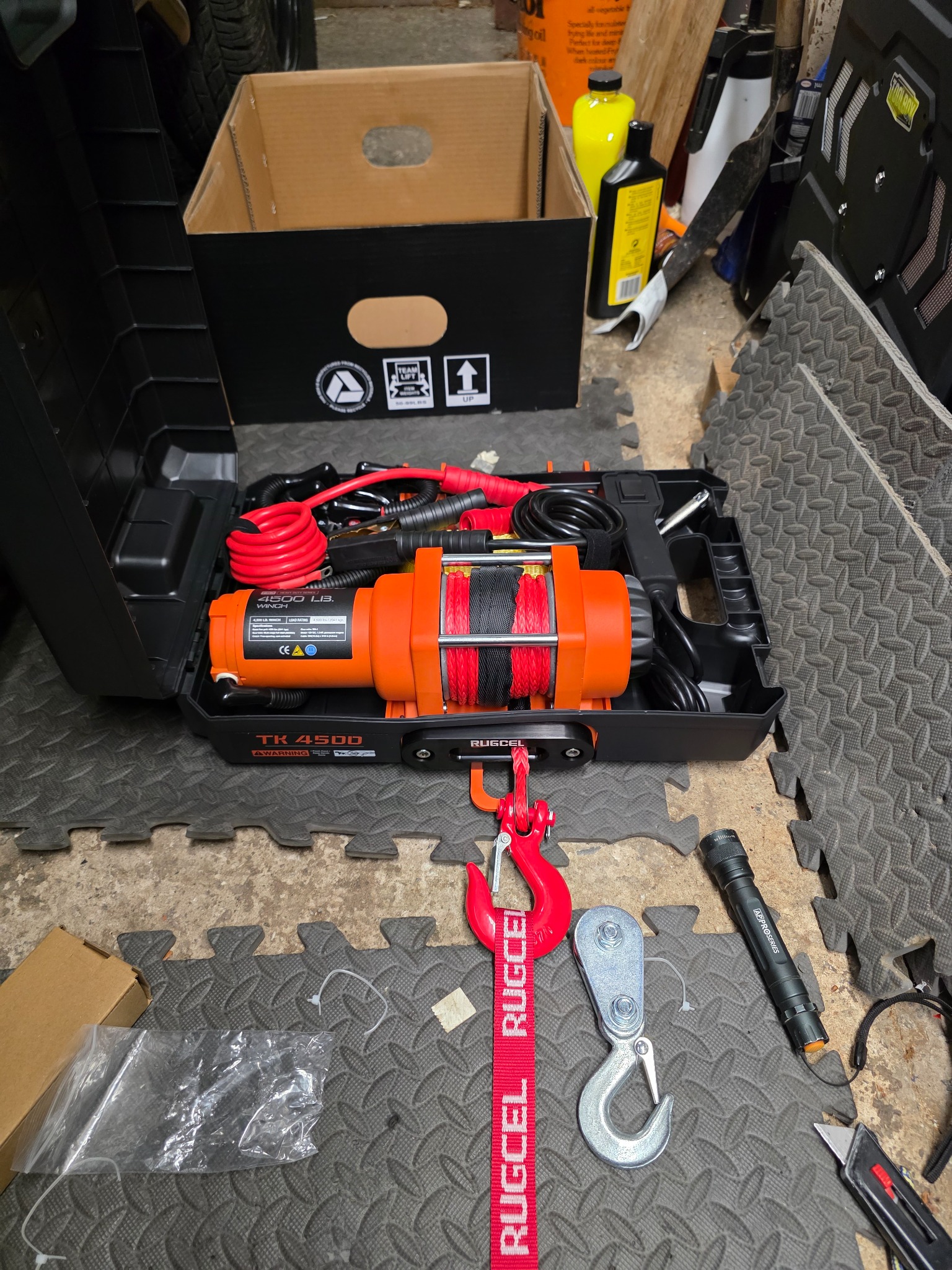

So here it is fresh out of the box.

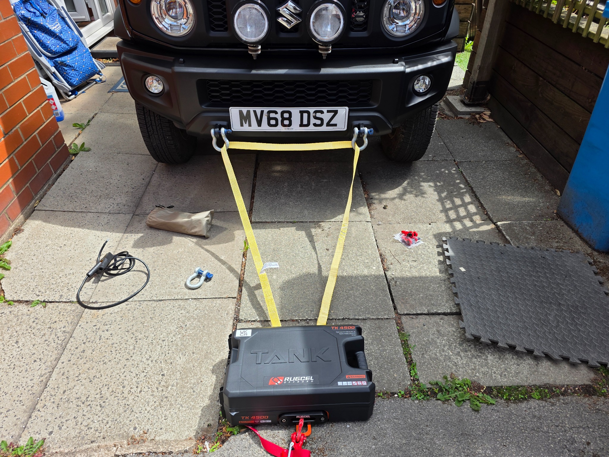

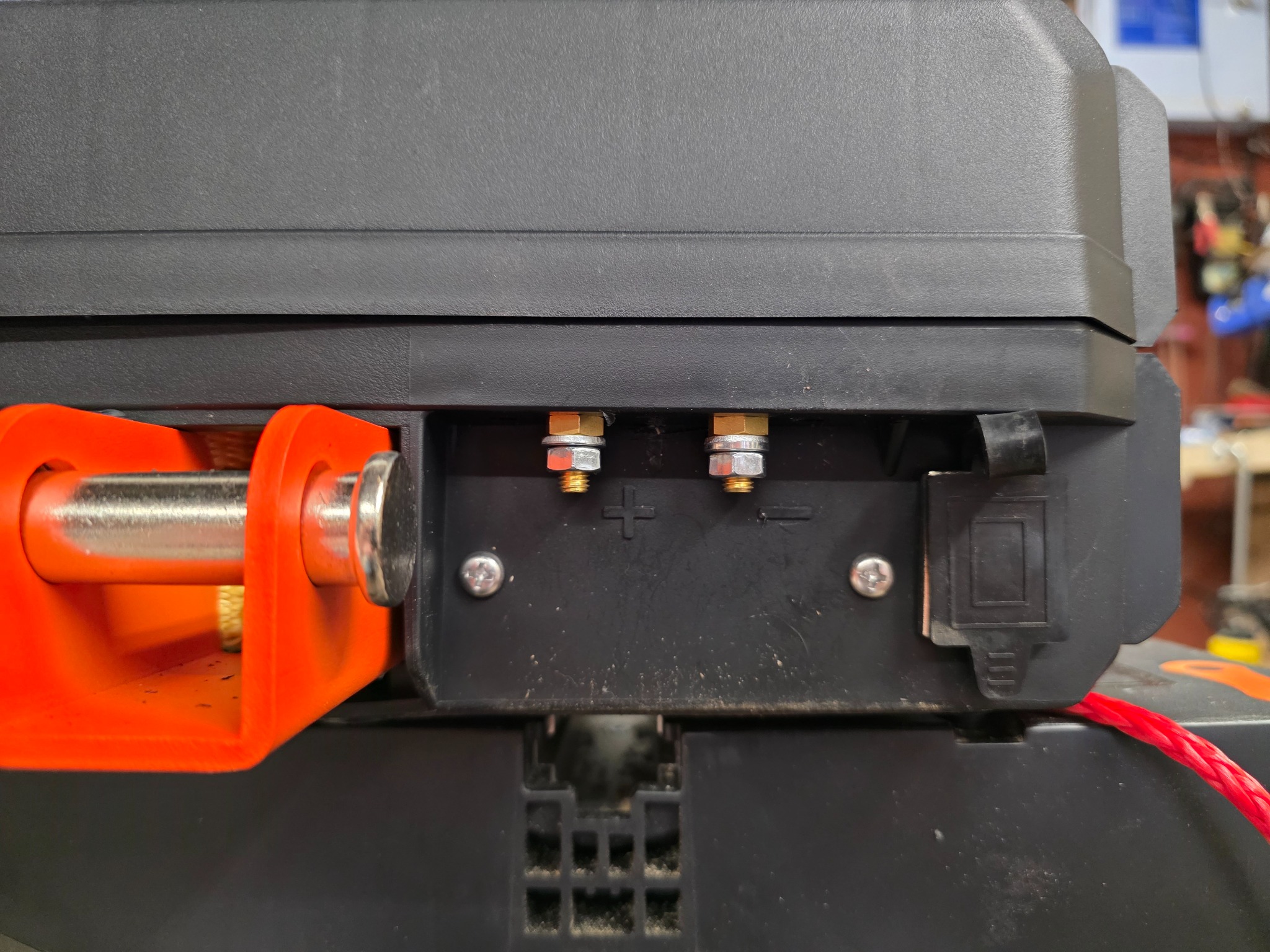

First fault, mounting it as shown, the battery cables were not long enough.

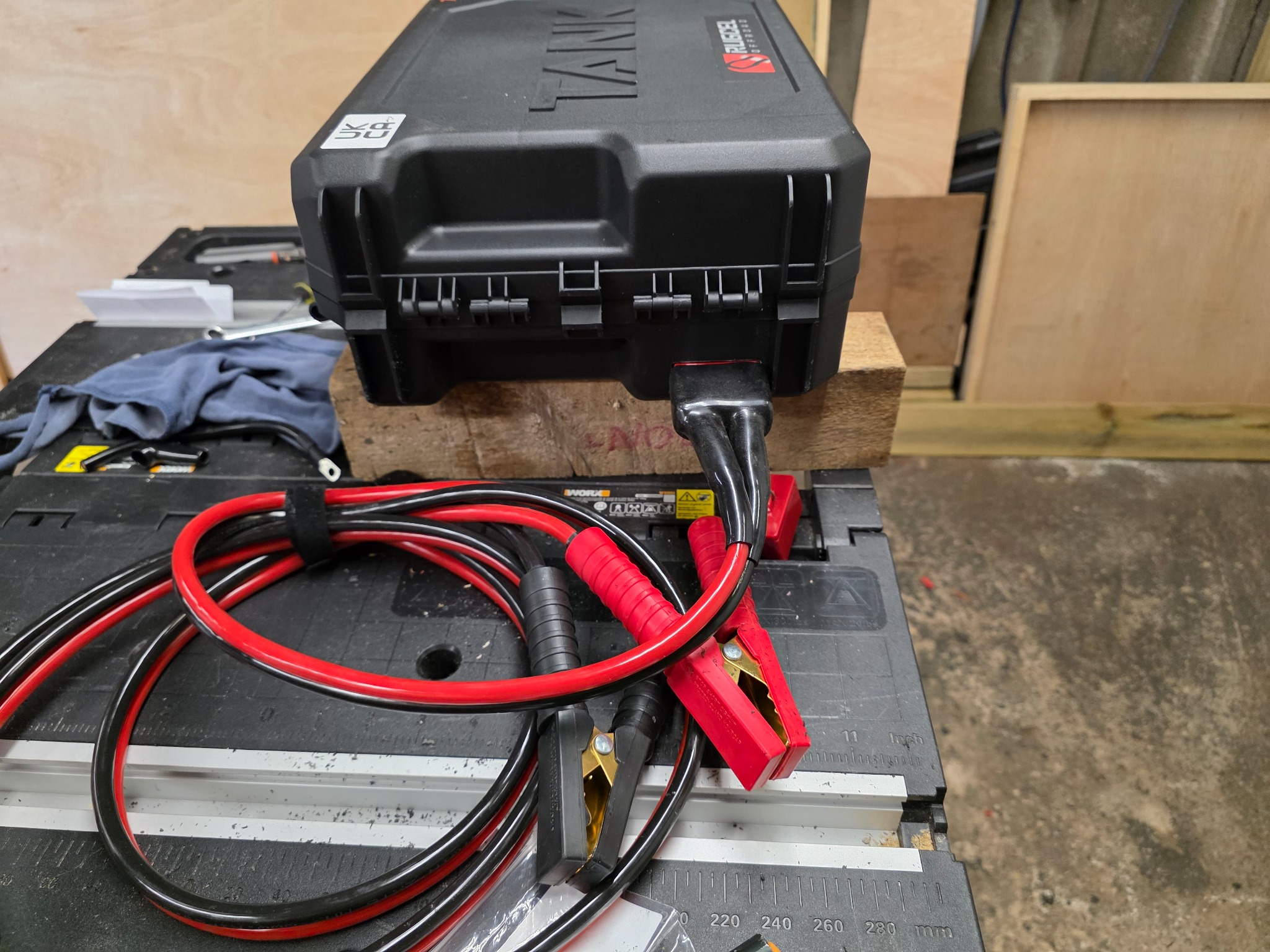

Second issue, I didn't like how the battery cables fix to the box. A bit too fiddly if you are having to use it out on a lane.

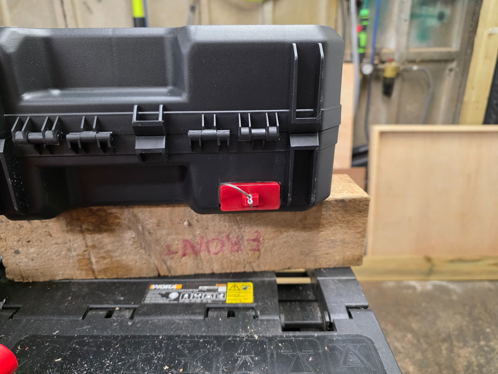

So I bought some longer cable, some Anderson connectors and covers and managed to fit them on the side of the box. Here the dust cover is in place.
New battery lead plugs in nicely.
It still all packs away (just) with the the 500mm longer cables.

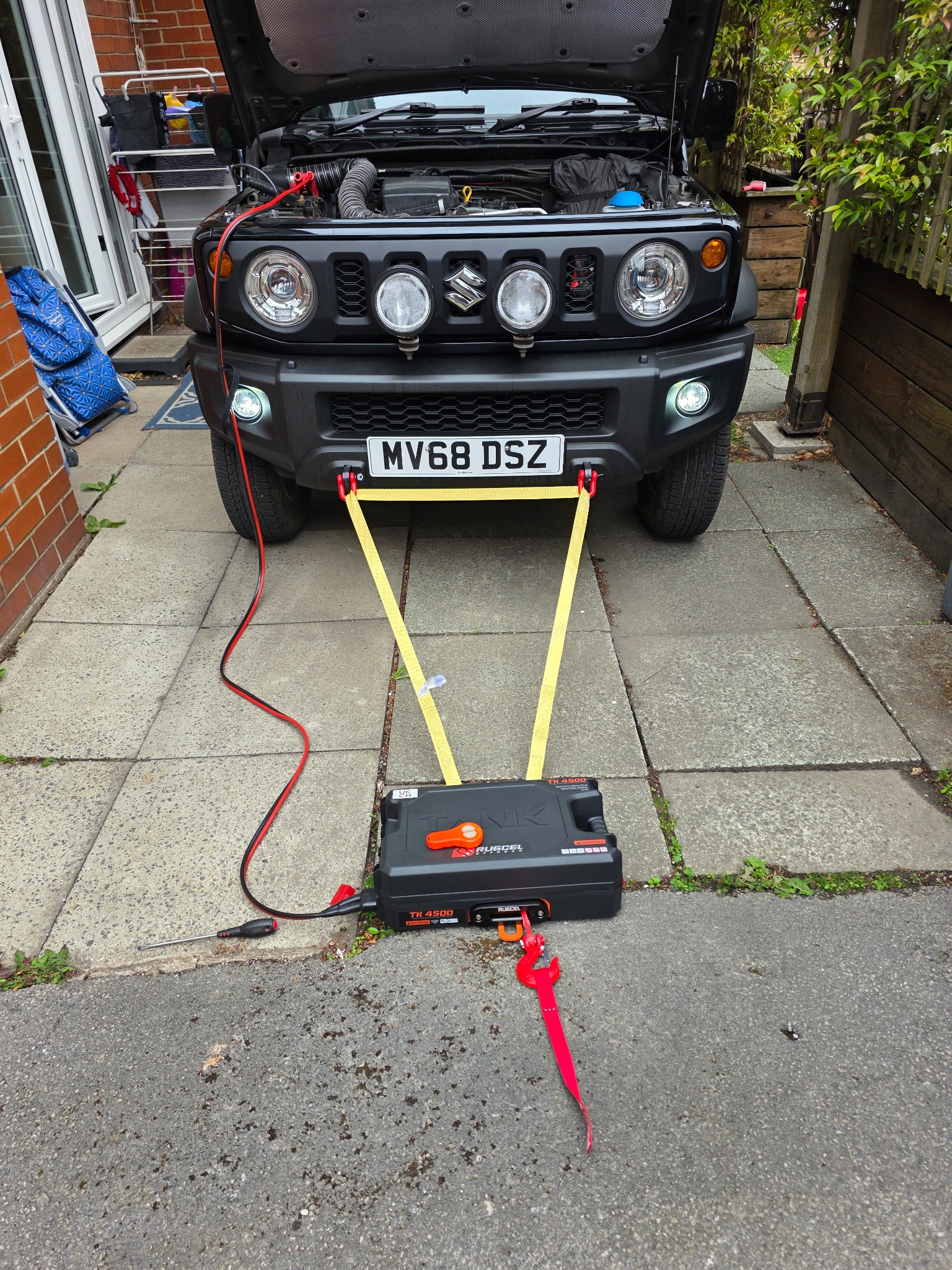

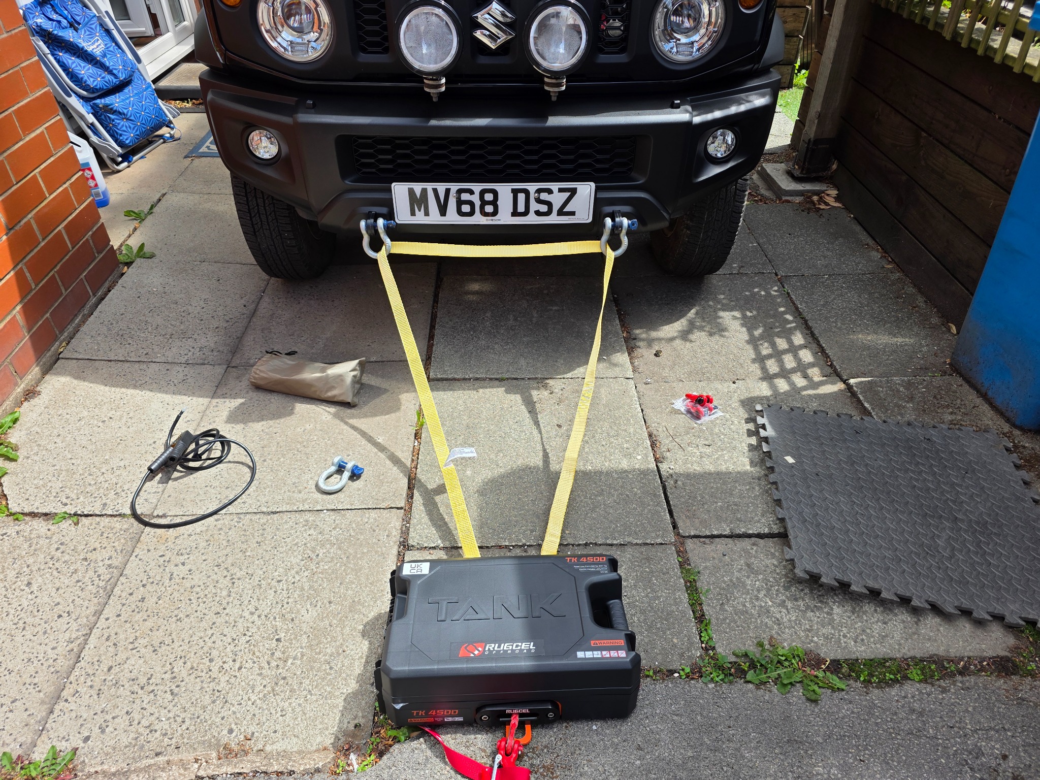

Now I can mount it and have plenty long enough battery cables.
I just need to go and test it out properly under load now.
- It is slightly smaller
- Cheaper (got it for £280 with Amazon Prime)
- 4,500lb capacity (500lb more pulling capacity than the Warrior)
- Better reviews on Amazon

What a fantastic solution. I take it you got the connectors, cables etc from Amazon too? Do the battery connectors still fit if you lower the bonnet?

I'm sure if the clamps were positioned better to bonnet could be lowered.

I'm curious as to how well this "solution" will work, the battery clamps are designed for short term use (jump starting) and may not stand up to the continuous high current draw of winching.
I also noticed that the rugcel (didn't look at the warrior) spec does not mention an amp draw figure.
