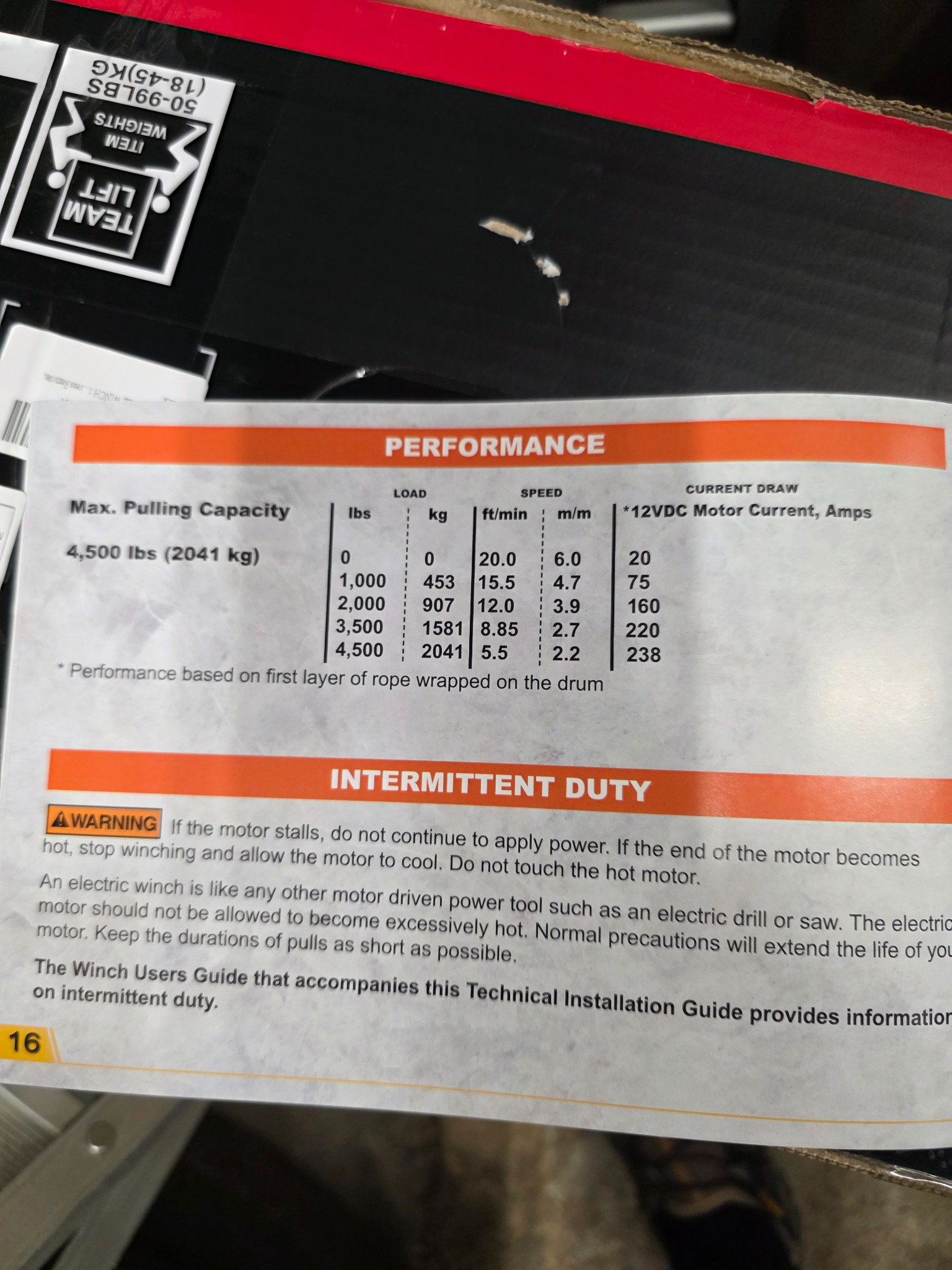

I'm sure it would be well within Soeleys ability to fabricate two short cables with an Anderson socket at one end and permanent bolted connections to the battery terminals at the other.

Thanks Roger, yes I could do that and TBH it is not something I had considered until Fordem mentioned it above.

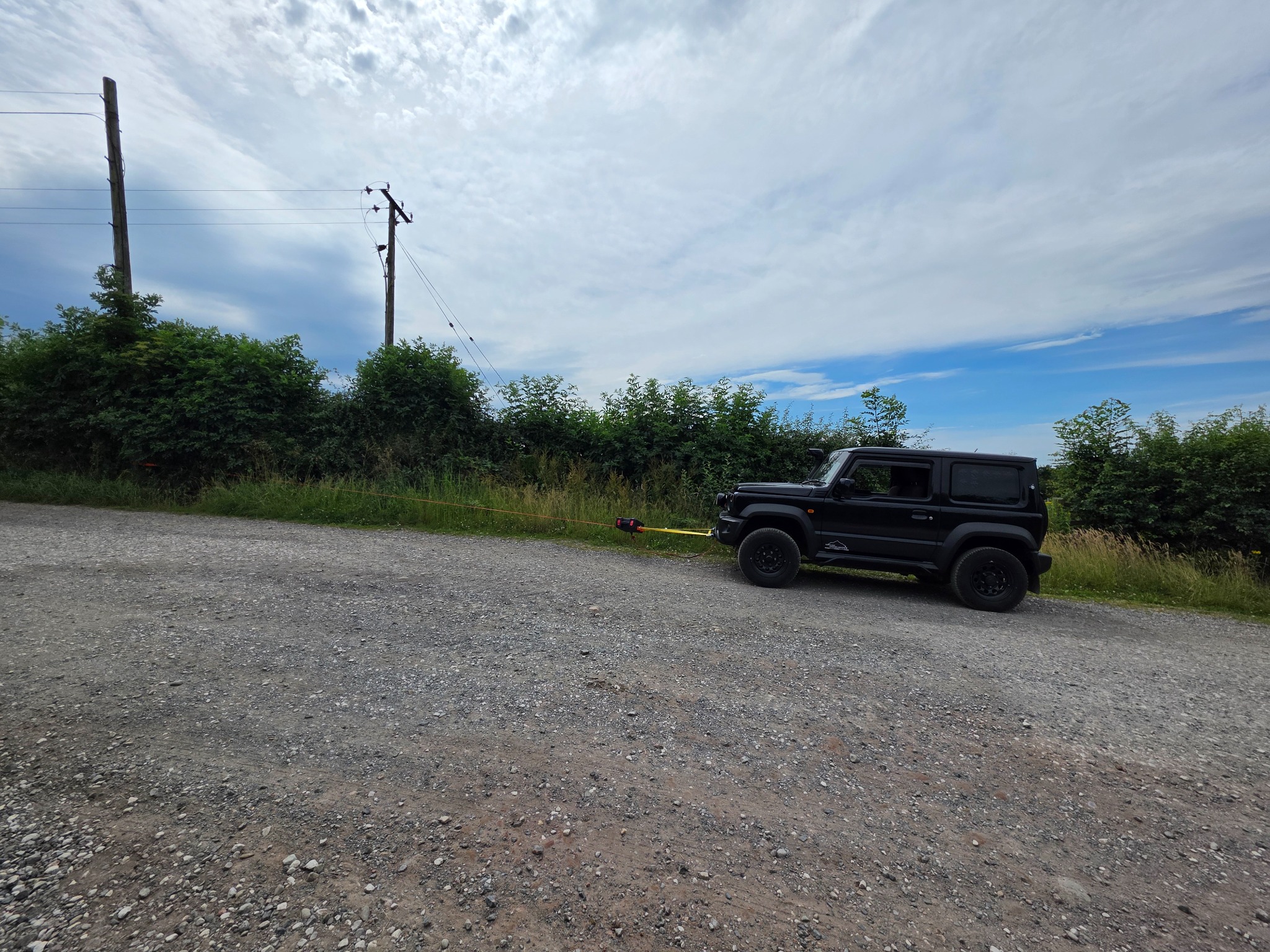

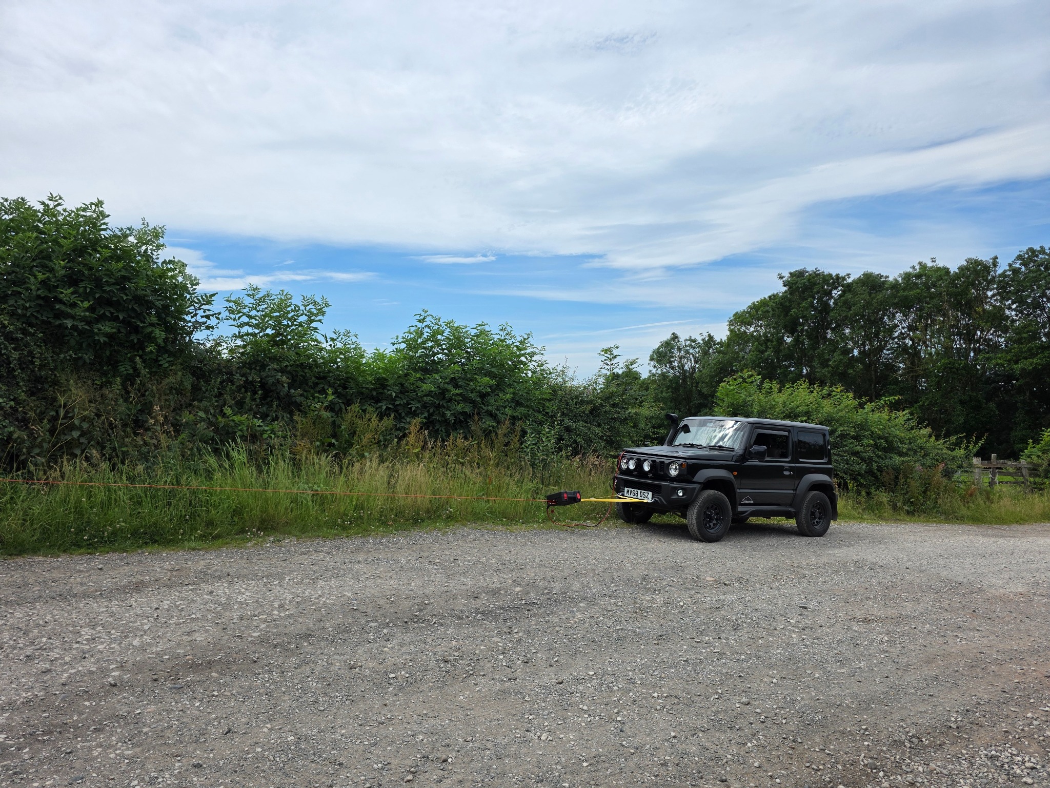

I thought about a portable winch I could fit to a plate and use on the front or rear for my last Jimny and then never did it.
This winch you have seems to come with a case that allows you to rig it up really simply. I would be really interested to see how well it works and might think about getting one.
A great find.

I got something very similar about 20 years ago with a plate that hooks over the tow ball or like you on a bridle off the front. No doubt it works but I have used it twice in years I've had it even on the farm. It's one of those where if I need it i don't have it or if I have it I don't need it.
