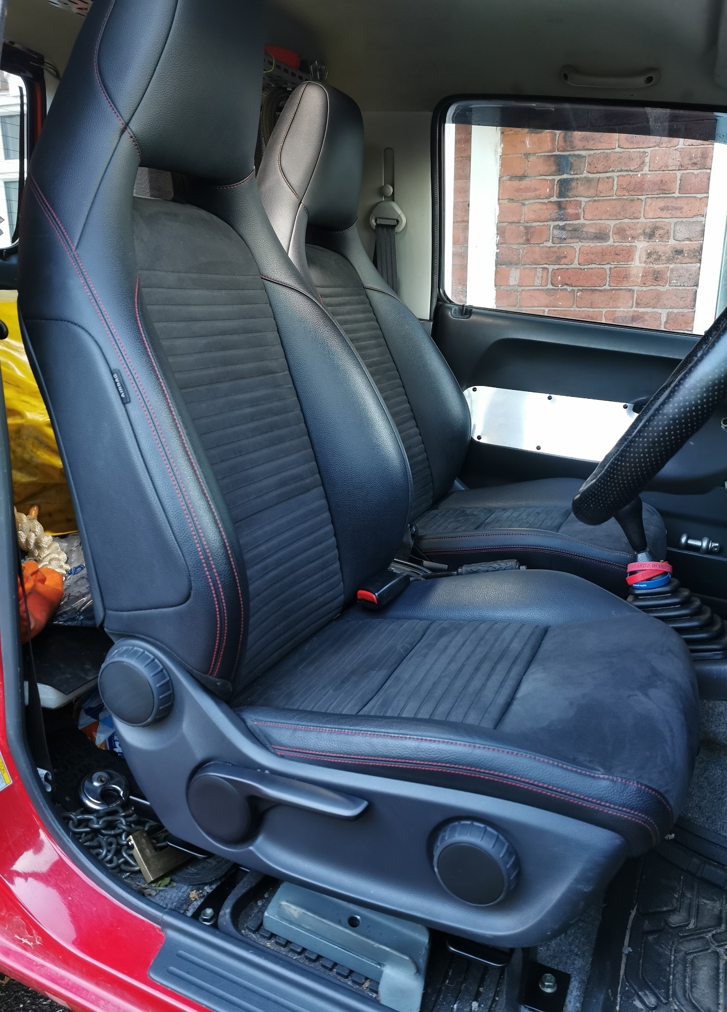

08 Oct 2025 16:46 #262234
Replied by jackonlyjack on topic Jimny seats
Mercedes W176 from 2017 A class
I already had seat subframes from previous seats fitted.
I got manual adjustment because these are flat fitting
Electric adjustment are not flat fitting
See picture of modification to door card to remove the armrest part....... Possibly if seats are further back[I'm short 😂] you could leave the door card alone
Door card mod was from my first set of bucket seats because my elbow kept hitting it
