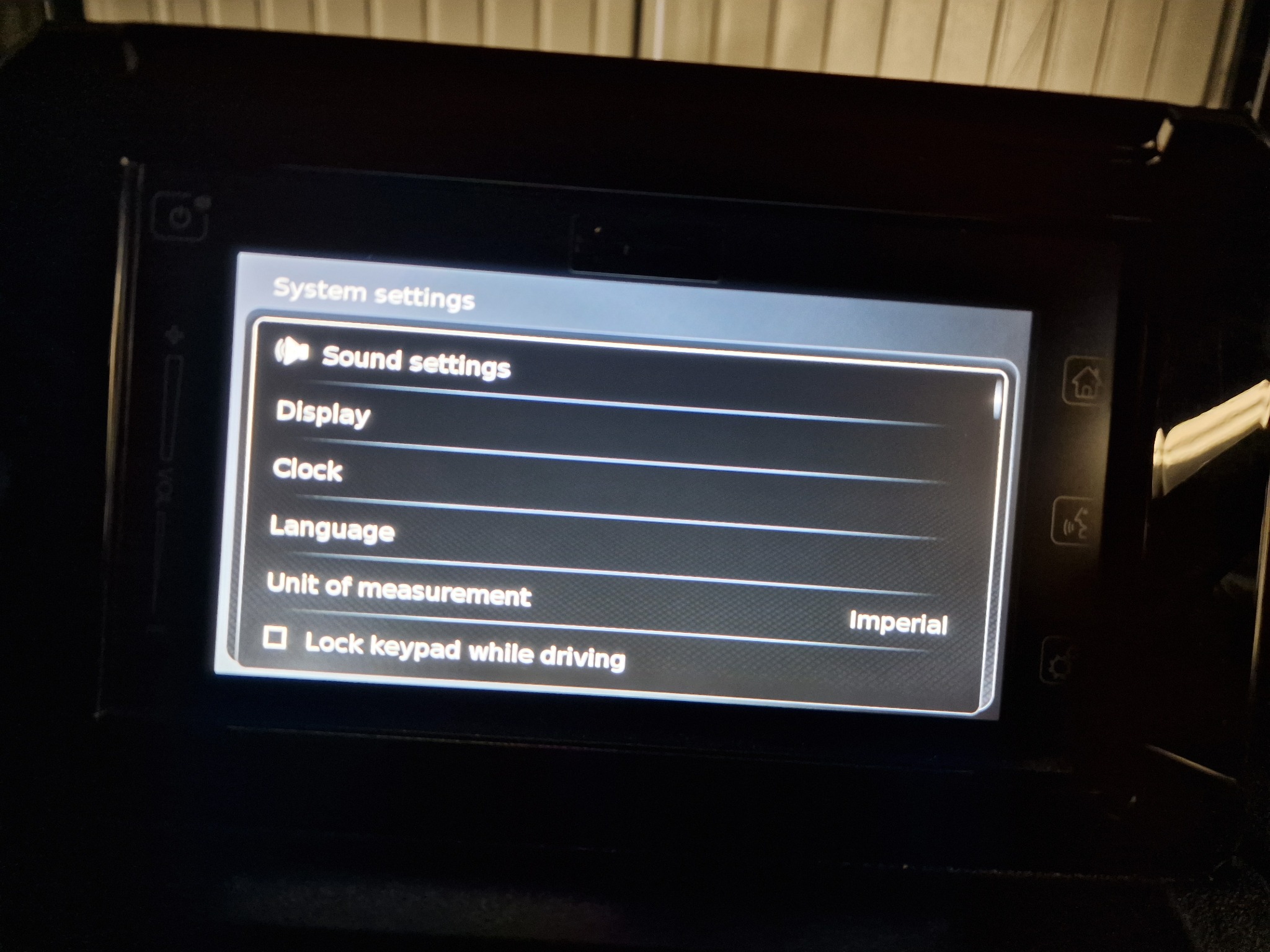

There are two settings menus on the Bosch head unit.
From the Home screen a quick press of the cog gives you.
From the Home screen a long press (12 -15 sec) gives you.
Don't know if any of that isuseful information?

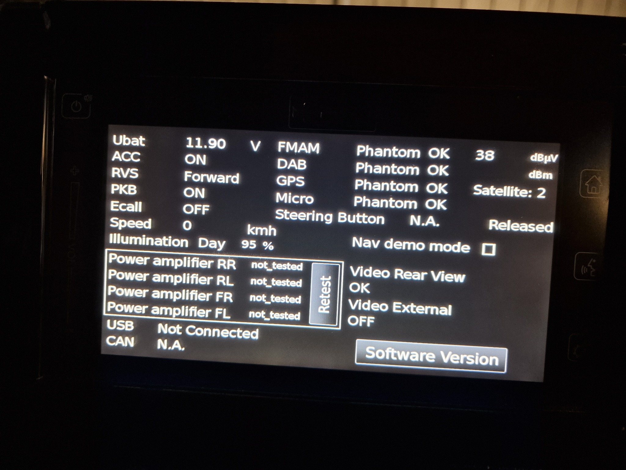

If you hold in the cog when you are on the DAB screen, you get this, but I don't think any of the numbers are signal strength.
(The screen is very reflective, and there is a fragment of Dog stuck to it...)
The 2 for satellites might mean your GPS doesn't have a lock and is dead reckoning based on distance and direction. (mine says 2 there as well but it can see 5 satellites ATM)
If you are on the navigation screen and quick press the cog you get a menu that includes position information, selecting that tells you how many satellites it can see (never enough) and what it thinks the position is. If there is no altitude, or the co-ordinates are blank then it doesn't have a lock.
The Bosch LCN is pretty useless for GPS in warm weather. I don't know if it is the atmosphere, or heat affecting the unit/antenna but I've had several and they were all the same!
Mine has always been rubbish on DAB, the one in the Citroen works much better, you can listen to RadioX classic Rock without dropouts!
(The GPS in the Citroen is equally rubbish, and is virtually blind to satellites this weather too...)
I blame the antennas, but mine has been like this from new, if it suddenly happened it might be worth looking for water ingress at the DAB antenna, I think the GPS one is thrown under the dash somewhere.

Some more testing

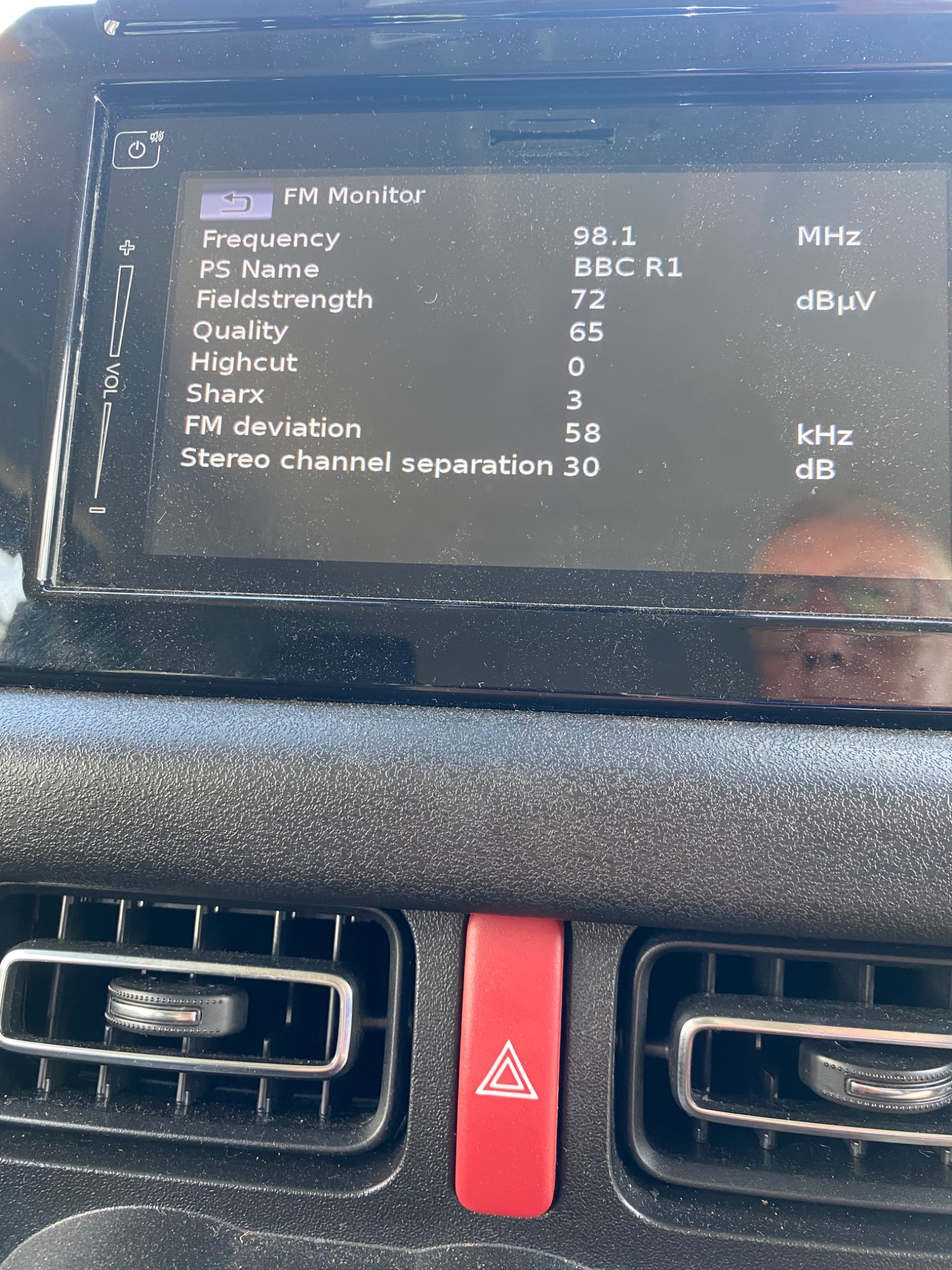

main screen with radio on FM, it shows a FM signal strength of the station tuned
FM screen

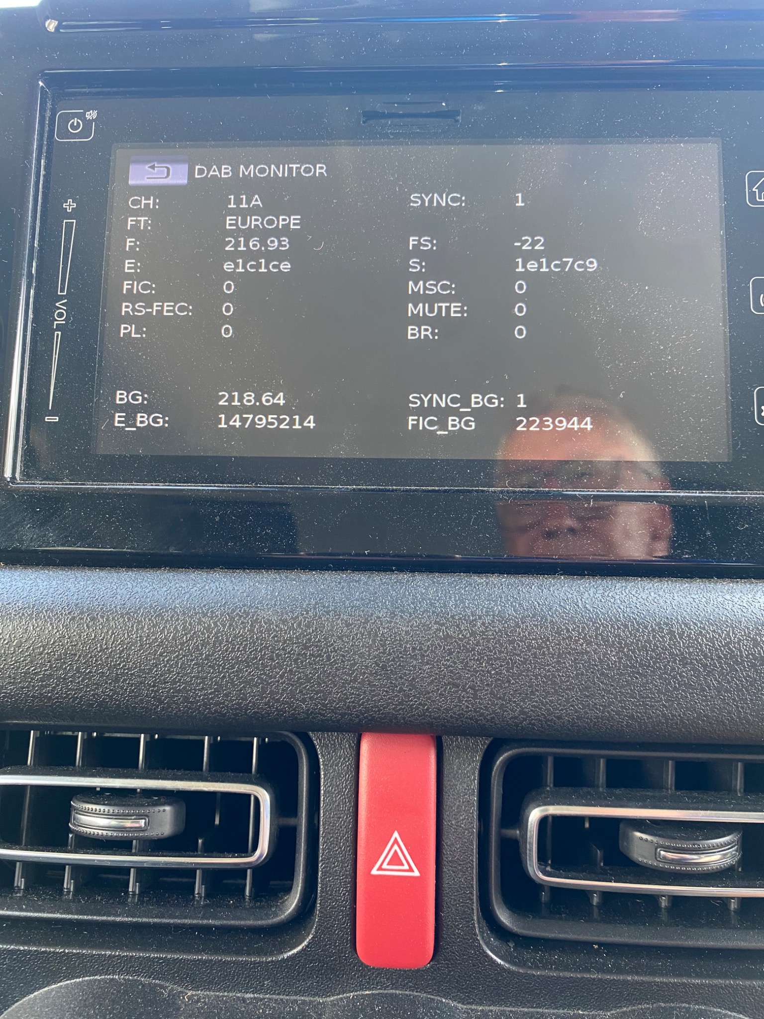

main screen tuned to dab, 0 FM signal

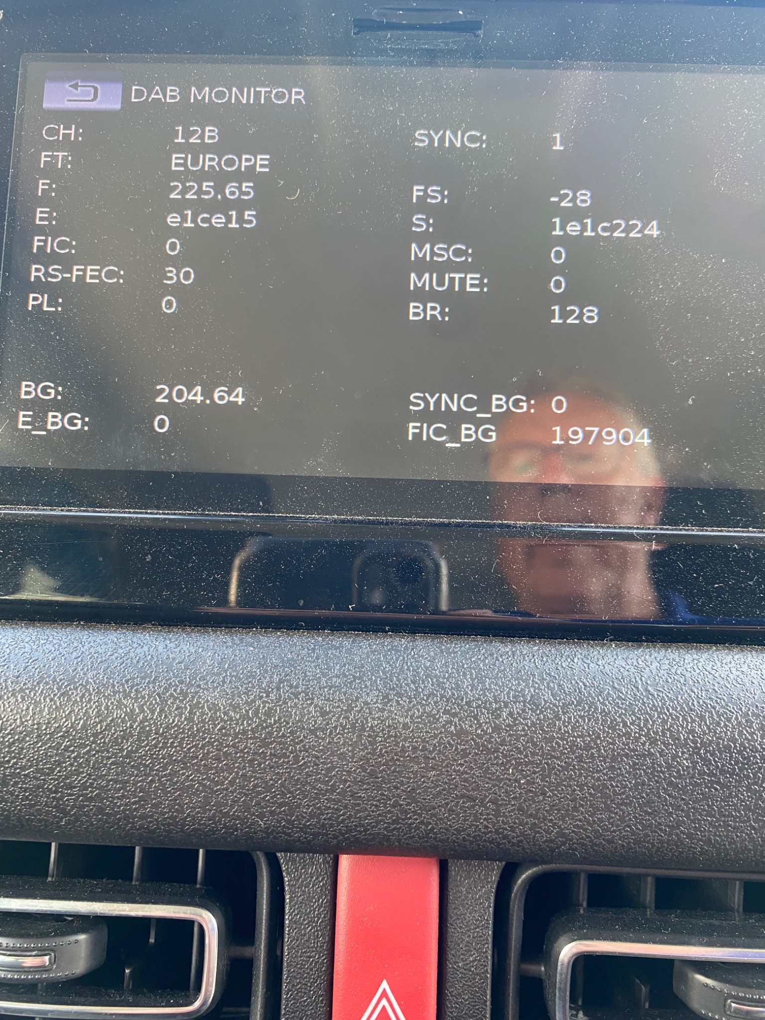

I also get -22 in FS or Field Signal
if I tune to bbc I get FS -28, bbc normally holds its signal for better/longer.
My other car doesn’t show signal strength, but does help decode the figures
if I test on a SDR radio ch 11a is -65dBm and 12b (bbc) is -72dBm, a difference of 7db, almost the same as the Jimny radio shows.
What worries me is if I unscrew the whip antenna the DAB signal stays the same, perhaps it doesn’t use the whip for DAB or indicates a break/bad joint?
FM screen

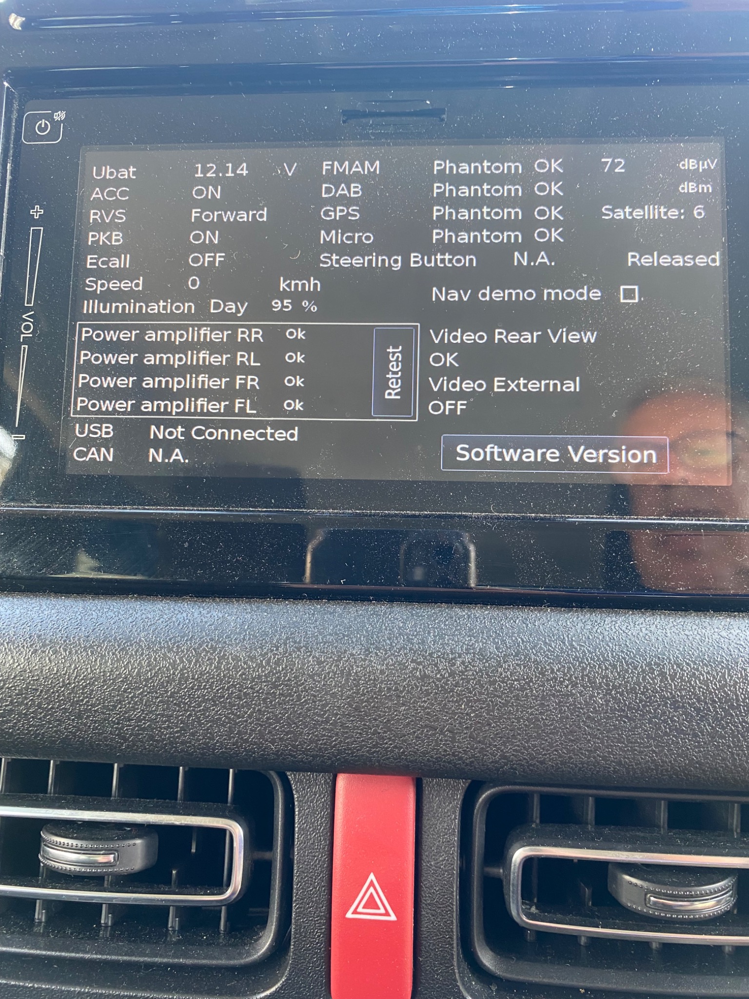

Just tested my antenna again,
with the antenna in place
FM is 73dBuV
DAB is -21dBm
If I remove the antenna
FM is 54dBuV
DAB is -21dBm
So the antenna is only making a difference for FM and not DAB, I need to get in to it for a look.
