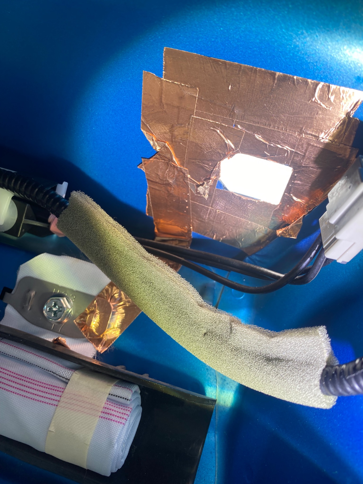

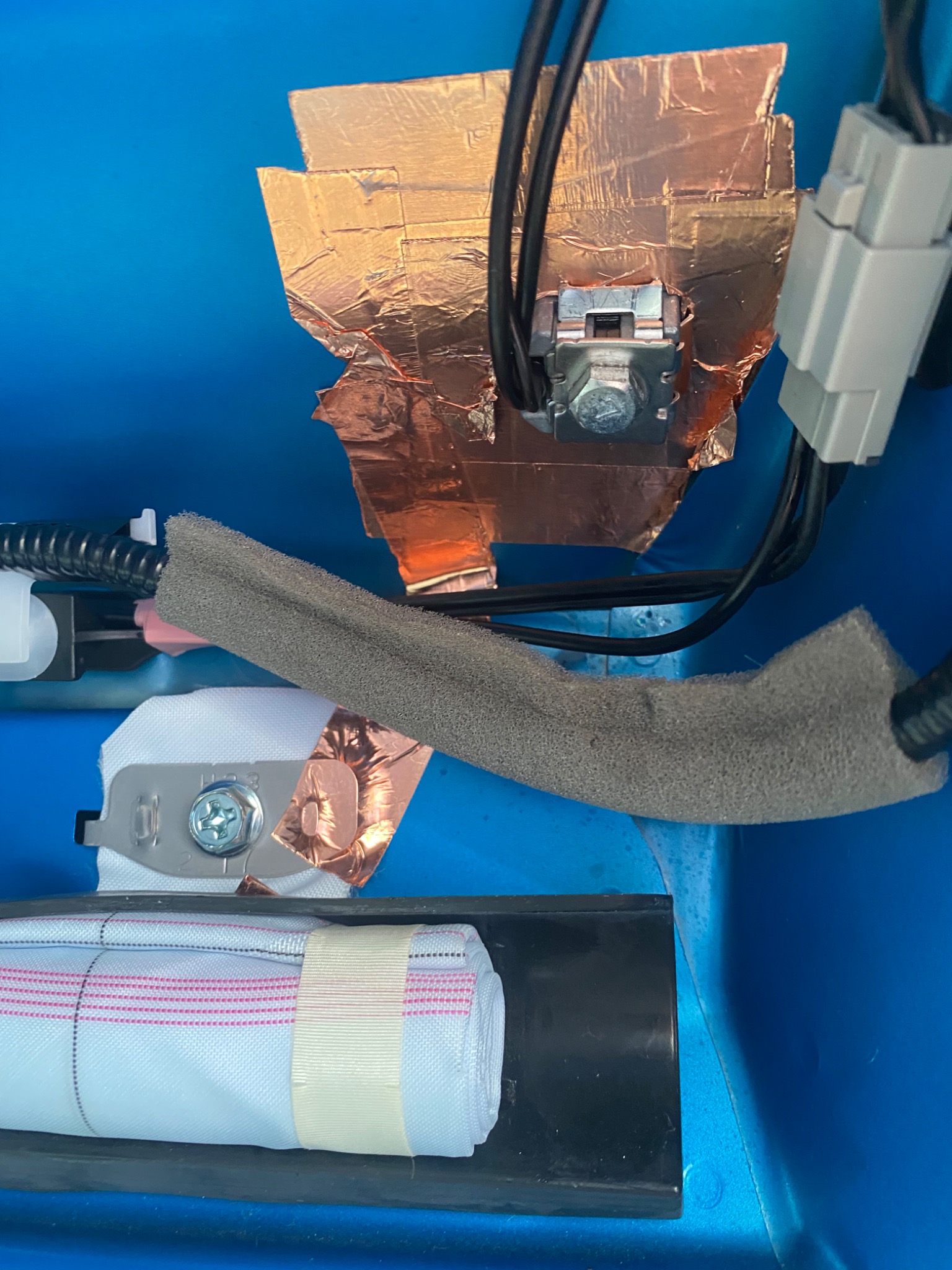

13 Jun 2025 12:22 #260892
Replied by DrRobin on topic DAB reception suddenly poor
Photos of the better earth
This is copper tape with a strap to the airbag fixing, good earth point.
Then with the antenna fitted
I have just been for a little drive, although not the standard test route and no DAB drop outs at all, so hopefully it’s fixed.
Thanks for all of the help.
Robin
Robin
13 Jun 2025 16:15 #260893
Replied by Soeley on topic DAB reception suddenly poor
I think the antenna clamp, is supposed to pierce the paint with it having 4 spikes on it? But the copper tape looks a better solution.
