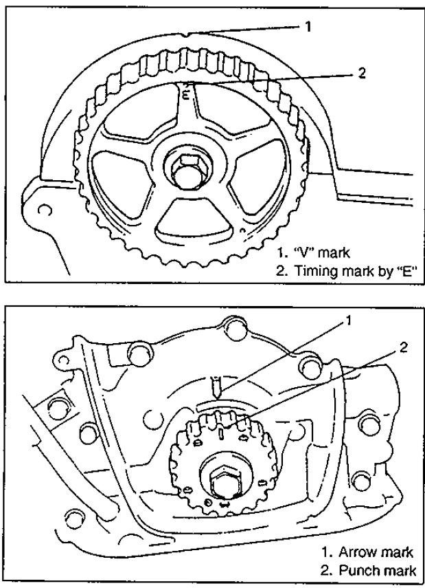

First things first though, I'll need to determine whether the timing is off.
Are there any markers on the crank or camshaft on this engine?
Apologies if this is basic knowledge, I haven't worked on one of these engines before, and there is a big plastic cover over the timing belt.

21 Feb 2025 18:01 #259552
by fordem
Replied by fordem on topic Engine required

I'm fairly certain that the G series engines in Jimnys are non-interference, meaning it is not possible for the valves to hit the pistons and incorrect timing won't cause any damage.
