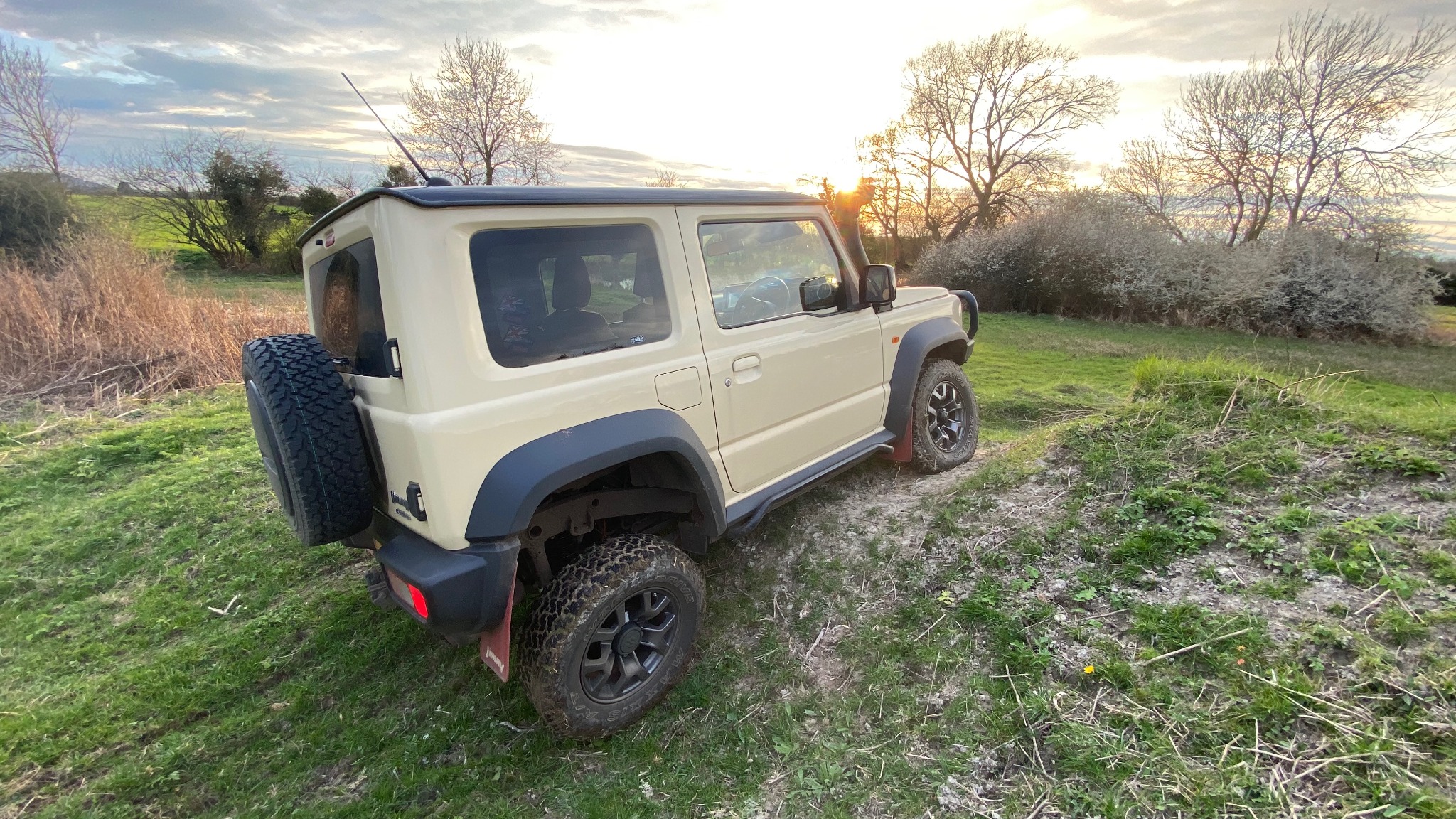

I have a 4th Gen Jimny and I also run Maxxis Wormdrives. I've done a set of 215/75R15's and just before Christmas upgraded to a new set in 235/75R15. Although I do have a 2" lift.
These have been great green laning. I also run Maxxis Wormdrives in 255/70R16 on a Land Rover Ninety which is also used for green laning.
I'd certainly recommend them as a good all round tyre. Although when I was looking end of last year, I struggled to find them for sale in 215/75R15. In fact, I have a brand new one (spare) and 2 part used that I kept when I swapped sizes in Dec. If you could find another new one, I'd be happy to sell the ones I've got (assuming you are UK based).
This is mine on the 215/75R15's:

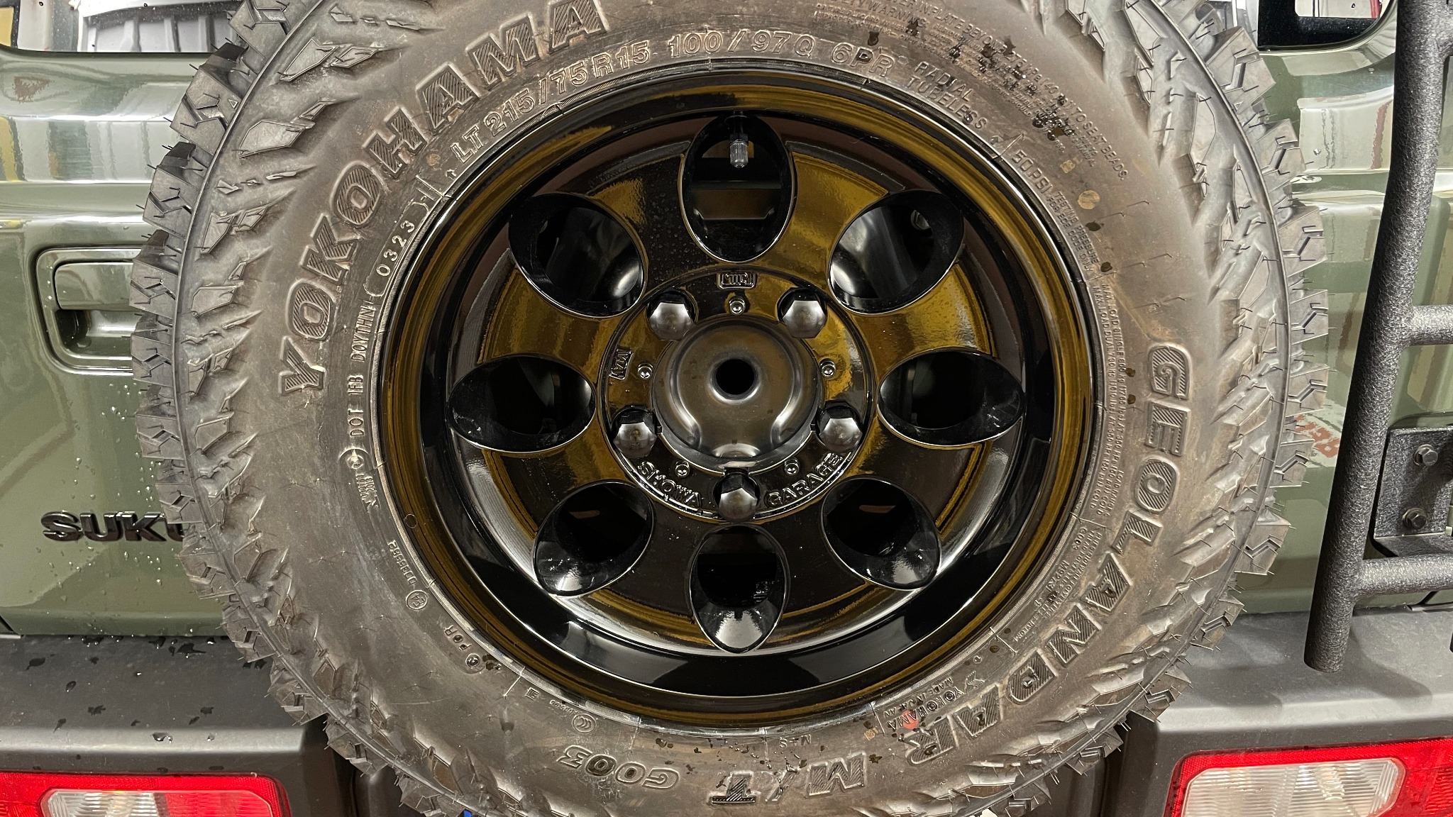

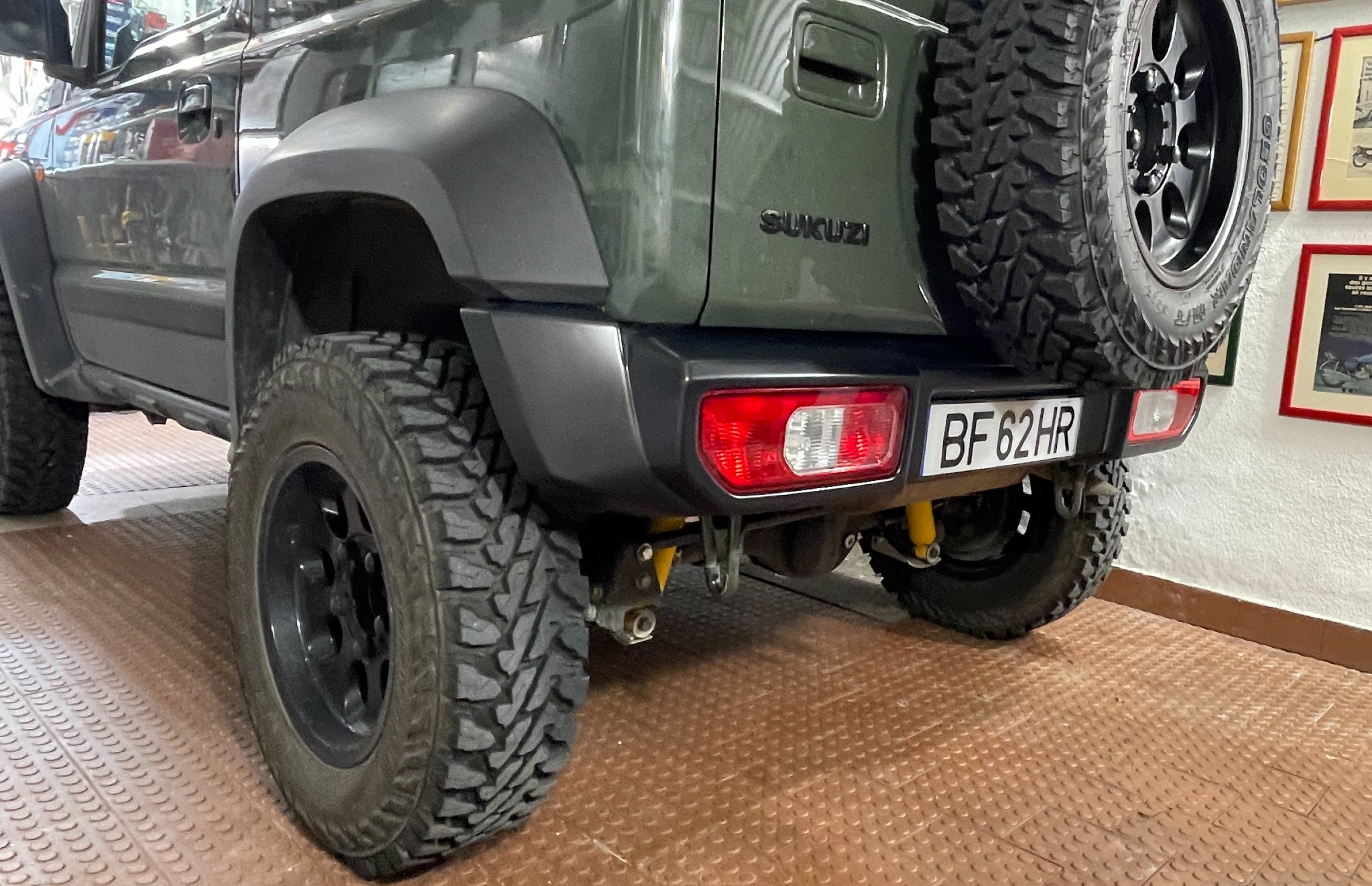

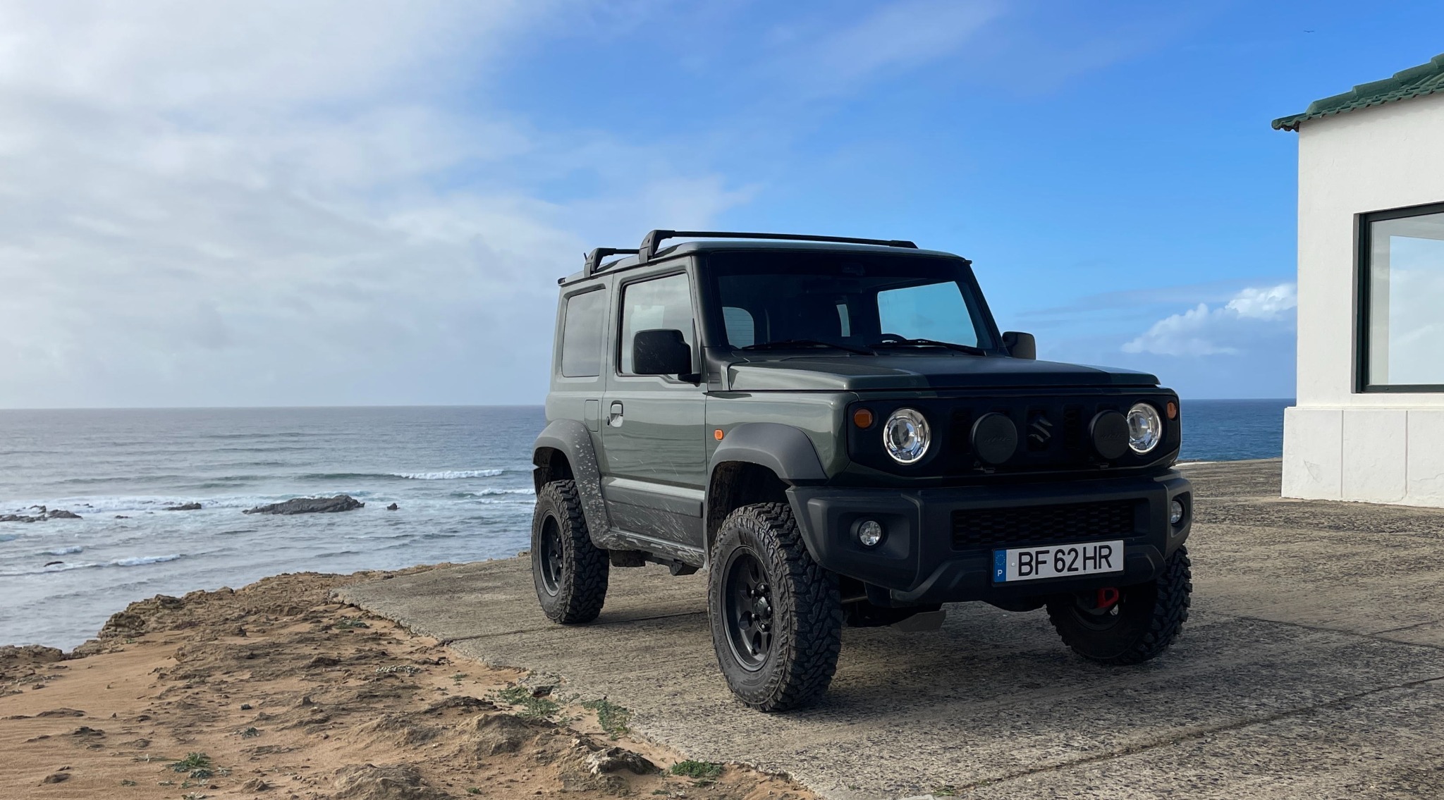

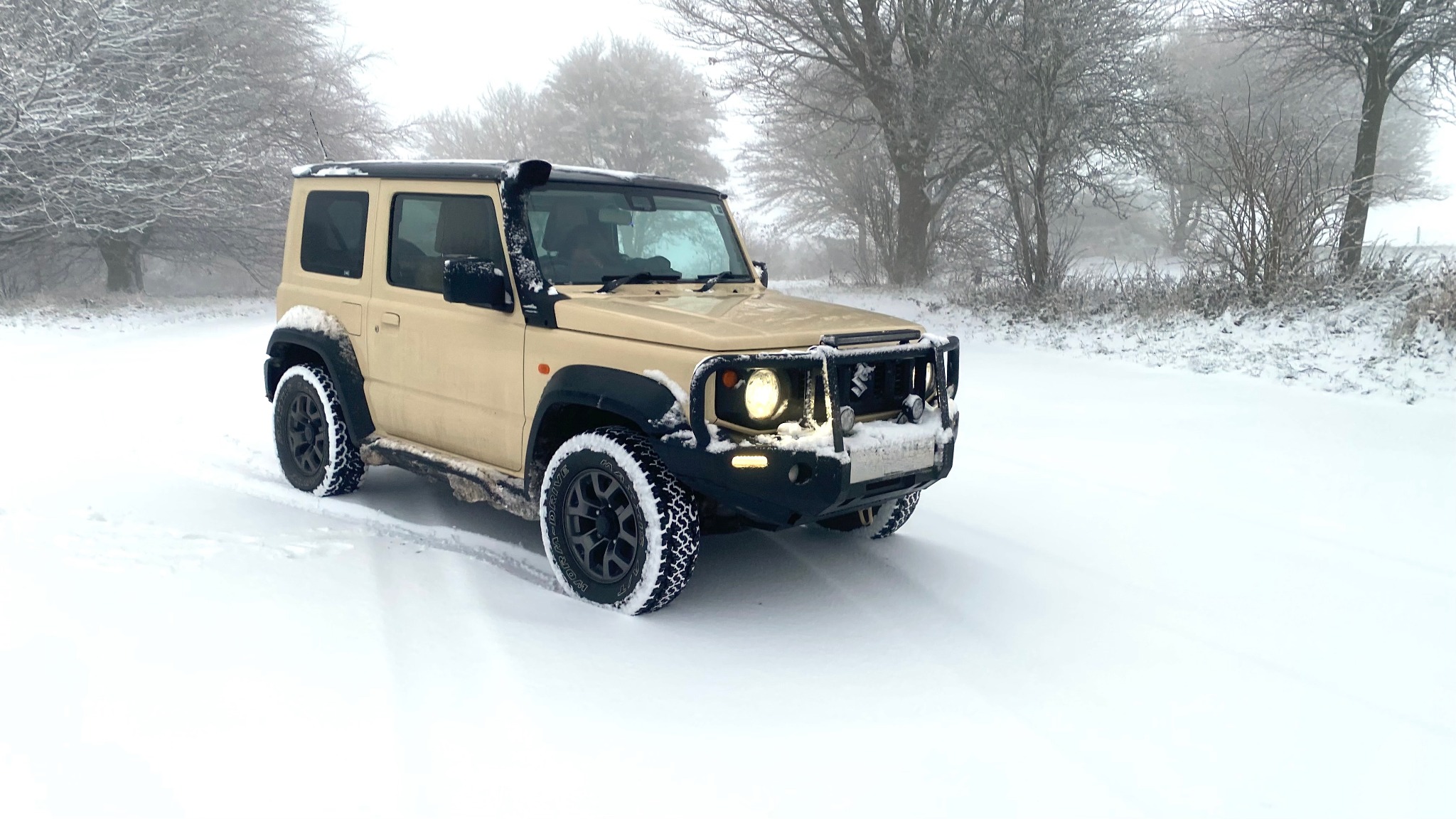

18 Jan 2025 21:16 #259140
by Filipao
Replied by Filipao on topic What tyres
