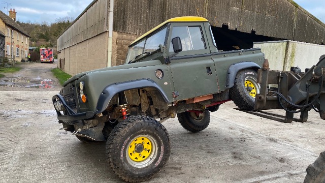

In terms of lifts, there are lots of ways. A body lift has advantages of being cheap, plus it keeps the weight low down. In reality a body lift is more akin to trimming the wheel arches. as it simply allows for taller tyre, but won't improve anything else (bar maybe bumper clearance and approach/departure angles if the bumpers are the lowest point, which they might not be).
A suspension lift can be good, but a poor lift can result in a poor ride and worse off road performance. So I'd advise doing your homework and ensuring you get a kit that will meet your demands, expectations and budget.
I only fitted a lift kit to my Gen 4 January time last year at about 4 years worth of ownership.
I would say, the Jimny's biggest issues off road are lack of ground clearance. The suspension is ok, but they don't flex like a standard Land Rover Defender. A good kit can give more travel, a better ride on and off road as well as a lift.
A suspension lift won't give more clearance under the diffs, but will raise the rest of the car up. The Gen 4 can certainly rub the radius arm brackets and transfer box off road. I don't see why a Gen 3 would be any different.
That said, green laning is not really challenging terrain and if it is, you have likely strayed from the lane or the lane is in no state to be driven. But if you plan other off road antics, then a good suspension setup should help a lot.
Ultimately I probably did the right thing waiting to lift mine, but it is a significant modification that has improved the vehicle. I'm also now running a bigger tyre, which I wouldn't probably have fitted on stock suspension.
I have the Black Raptor Premium 2" kit on mine. However, my Jimny is my daily driver and I have other vehicles... erm, toys.... for more serious off road use. If I was building a Gen 3 up as a laning toy, I'd be saving for a 3 or 4" full kit with all the bits.

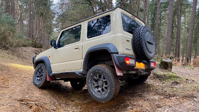

My Jimny can't do this:
