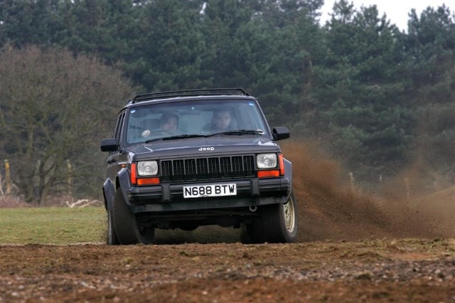

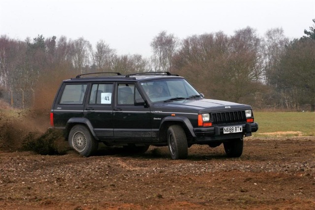

At an event a number of years back.
Replied by 300bhpton on topic Buying a gen3 for green laning
The ones I've driven all drove and handled great. Certainly no worse than a Jimny or Defender.As for jeep, I can get a flock of sheep to change direction in a more convincing manner, the steering is just generally vague and it seems to be universal having driven live and ifs cherokees and various versions of wrangler in different stages of modification.

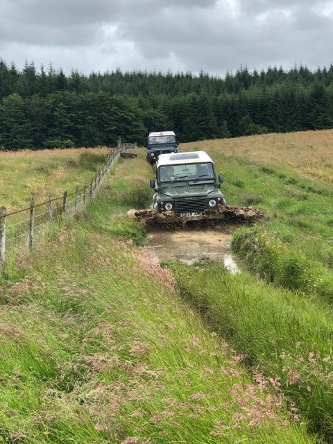

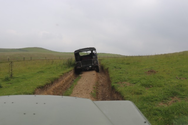

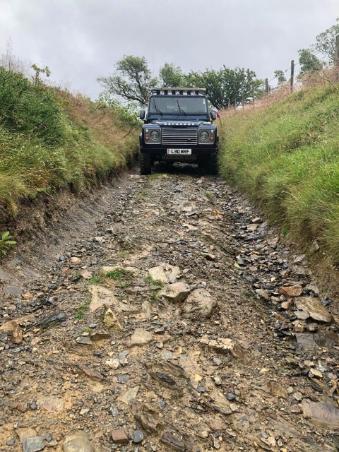

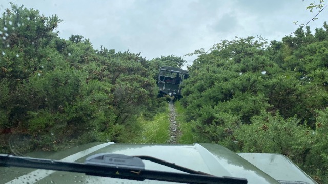

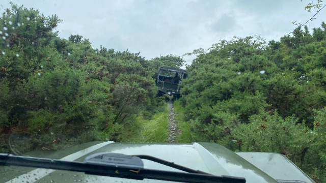

e.g.
All the above are Welsh lanes.
I'd say this very much depends, there are lots of lanes where you get very little choice on where you can drive and end up having to follow the ruts.As for ground clearance, Lambert is right, you can pick your own line and straddle the rutted tracks
Robin
e.g.
