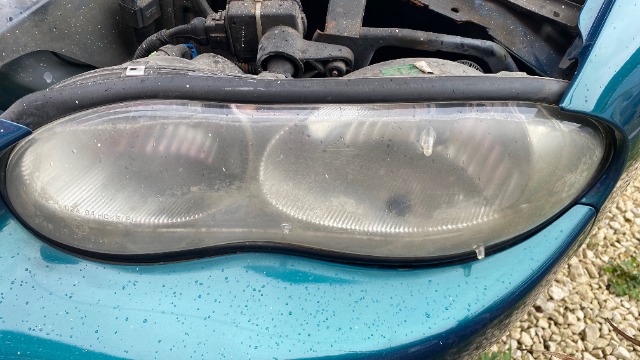

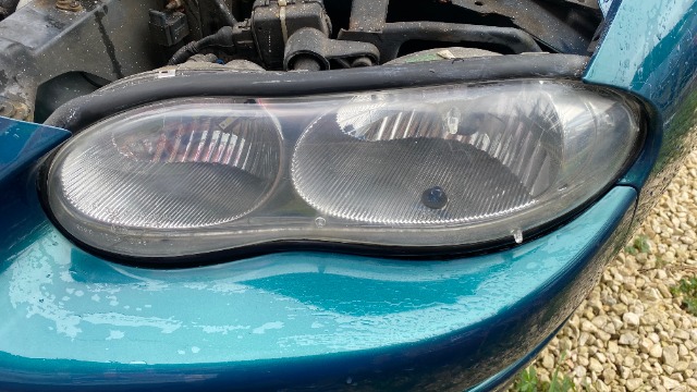

29 Oct 2024 10:43 #258090
by 300bhpton
The plastic can usually be cleaned up with a little effort the 3M kit works very well: amzn.eu/d/1YFyGkR
I did the headlights on my Camaro with this kit, only take 10 mins or so per headlight.

Replied by 300bhpton on topic 7 inch headlight
So I have noticed that the tops of my headlight outers are starting to cloud. There are various options including buffing or covers at one end of the cost scheme and then like for like replacement or even led replacement at the other end. However I am wondering if it is possible to fit a 7 inch headlight unit like say a trucklite or similar and then have a separate indicator to the side. I'm sure I could do something with some flat abs or similar and pick up existing mount points but it's likely to look odd or incomplete. So to that end I have been looking for a moulded surround and I am struggling to find anything. I might have said print something but I'm not literate enough in that respect. Has anyone seen something available to buy?

29 Oct 2024 12:03 - 29 Oct 2024 12:04 #258093
Replied by yakuza on topic 7 inch headlight
totally agree on the LED's, I will be using standard halogen H4 glass and metal inserts and most likely Osram nightbreaker.
The high kelvin white is no good in the snow, you loose the depth. More yellowish light and you will easier see the contours and edges of the road.
The 3M kit is what i used on my Jimny earlier and on the Swift. First time I used it I was way to careful with the grinding, should have gone on for longer but was afraid to not being able to buff them back up. But it was no problem and they have held on for a few years.
Swift was only matte and came out OK.
