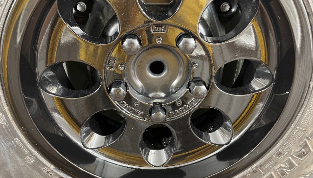

06 Mar 2024 22:52 #254876
by Hughes
Replied by Hughes on topic Wheel balancing - Centre (hub) or stud
Are the factory alloys not hub centric? normally wheels supplied on a new vehicle have the correct centre bore in them? I've never investigated Jimny alloys as I'm a steelies guy.
It's when you go aftermarket things get tricky, as rim manufacturers often make the centre bore larger to fit a wider range of vehicles. (some rim manufacturers make rims specifically for vehicles - ROH for example make a rim specifically for the Jimny).
We regularly machine spacers for a local tyre shop (the one I personally use) to take up the gap between the hub spigot and the aftermarket alloy rim centre bore, mostly because its better safe than sorry and easier than getting info out of OEM's about whether or not they're actually required for that vehicle.
From my experience steel wheels tend not to be hub centric, (at least the cheaper ones) and alloys nearly always are (or can be), mainly because alloys are machined in one setup, and as a consequence the centre bore is true to the bead.
All this to say balancing a stock alloy rim that is hub centric should be fine either way, through the centre bore, or with a stud adaptor. Its just a question of whether or not the stock Jimny rims are in fact hub centric. Would be very strange if they're not.

07 Mar 2024 08:13 #254878
by facade
Replied by facade on topic Wheel balancing - Centre (hub) or stud
You'd think the alloys are hub centric- it is less trouble to machine the rim true to the centre hole than eccentric!Are the factory alloys not hub centric? normally wheels supplied on a new vehicle have the correct centre bore in them? I've never investigated Jimny alloys as I'm a steelies guy.
07 Mar 2024 08:44 #254879
Replied by mlines on topic Wheel balancing - Centre (hub) or stud
The trouble with "Hub centric" is not only does the wheel centre have to be accurate but the hub itself has to be machined to a high standard, Take a look at the hubs on a Jimny
