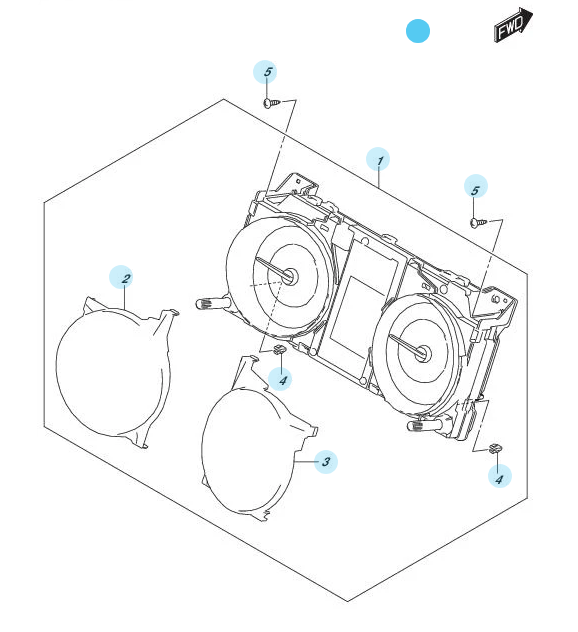

Kermit will probably not be disassembling the speedo, for the reason I noted above: there isn't a source for components. This is what the instrument panel page looks like in the Suzuki parts book:
If an MPH instrument panel is indeed necessary, the entire pod will have to be replaced and most likely will need programming by a Suzuki dealer.
Just in case it is on people's minds as they read this thread, it should be noted that -- in addition to being necessary to change the instrument pod as a complete unit -- it is also typically not possible to fit a secondhand instrument pod in a car of recent vintage. This is because the controllers inside the instrument pod communicate with other components on the car at power-up, and if an instrument pod from another car is fitted it will typically be rejected by the car's computers. This will typically result in an odometer error message -- which I'm assuming neither your insurers nor the MoT man will like. Cars today are configured like this to hinder unscrupulous people dialing back a vehicle's mileage. I mention this only so that someone in the future, bringing a foreign Gen4 Jimny into the UK, doesn't just assume that they can buy a secondhand MPH instrument panel and plug it right in -- in a modern auto, that usually doesn't work. I have never tried it in a Gen4 Jimny, and I suppose one never knows, but I'd advise caution.
On the plus side, for Filipao, that means that secondhand instrument pods for newer cars will typically be very cheap, being essentially useless -- so if you can find one for a Gen4 Jimny, it won't cost much to experiment with getting it open and removing the little speaker that makes the indicator noises.
