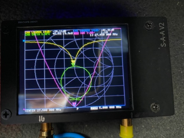

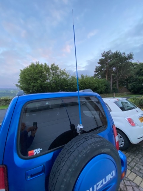

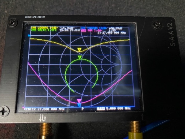

The stinger antenna was a bit long so I bought a flexible FireStick type antenna, that is about 300mm shorter
i also tuned it to the centre of the band, SWR is almost 1:1 in the centre rising to 2:1 at the UK & EU band edges
Just for completeness I also tuned the stinger, it was about 1.3:1 band centre but only about 1.6:1 at the band edges
Quite a good morning’s work tuning antennas.

As for the antenna cable, I wanted it hidden, that way it won't get snagged or pulled, hence burying it in the door and next to the wiring loom.
My short flexible Firestick type antenna is still too long, so I bought a swivel joint and when laning, just angle it back by about 45 degrees, then it does hit.

The network analyser started life as an open source project called 'nanoVNA' and sold some 'official' ones through a website, but as they open sourced the design the far east copied it and sold them for a lot less, plus you could get one rather than siting on a waiting list.
I have two of these, an original 2.8" screen NanoVNA that might be a genuine one (up to 900MHz, but updated firmware to 1.5GHz) and the one pictured above that is a NanoVNA V2 (2.8" screen) up to 4GHz (most likely a copy, but works without fault).
Both work well but both screens get washed out in sunlight, so a sun shade is needed in anything other than a cloudy sky.
Before updating the text was large enough to read on the original but now I struggle a bit in bright light and sometimes use a magnifing glass. There is a PC connection that will scan more bandwidth and more data points, but refresh rate can get a little slow, handy for my multiple band HF dipole.
