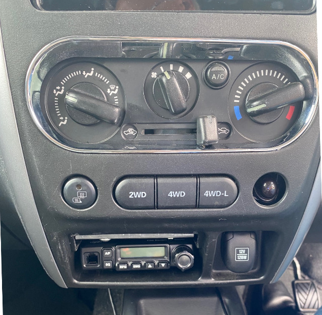

I bought a PNI 6500 CB, it is so small it fits in place of the ash-tray

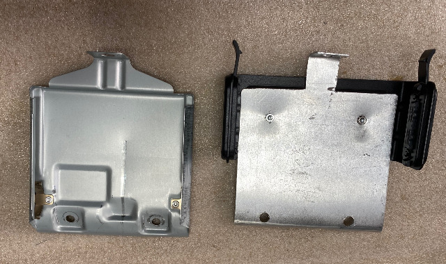

To hold it place, I made a new ash-tray holder out of aluminium and bolted the CB cradle to it.

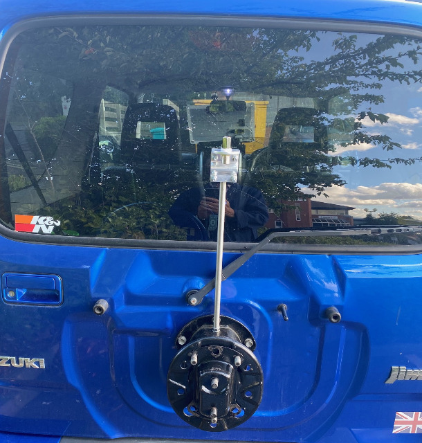

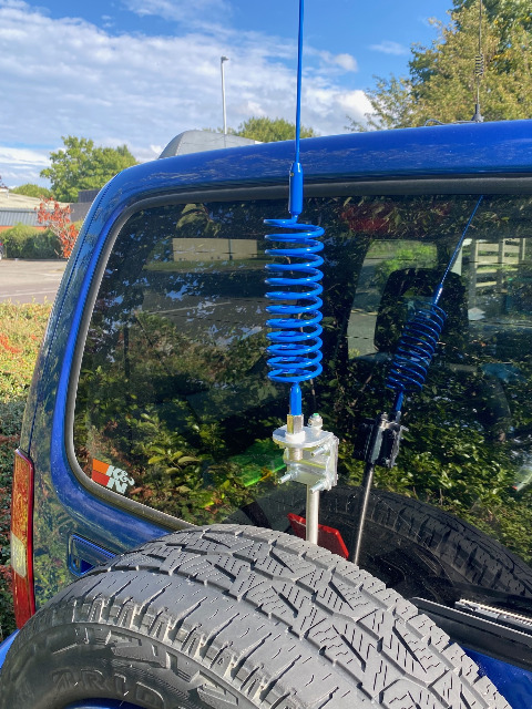

For the antenna, I wanted it on the back and went for a 'Spring Stinger' colour coded to the Jimny.

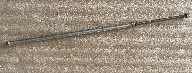

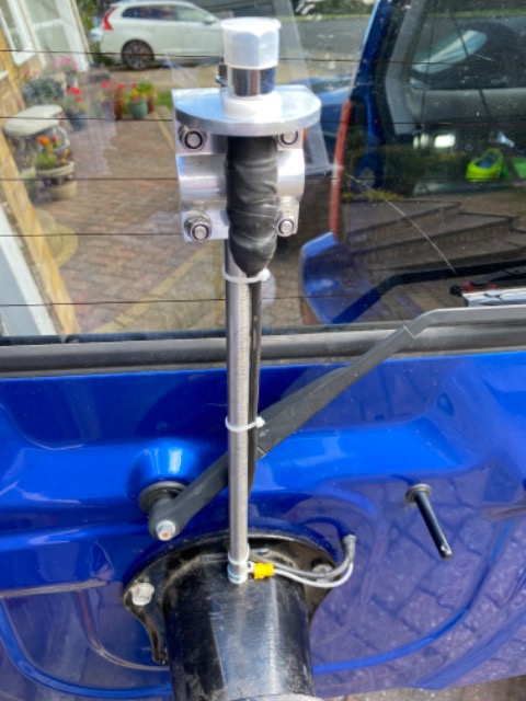

I made an antenna bracket from some M8 Stainless threaded rod with a M8 Stainless tube, then drilled the spare wheel holder.
A few Stainless nuts and washers complete the bracket.
The fit is quite snug between the spare wheel and rear wiper blade, but it all goes in.

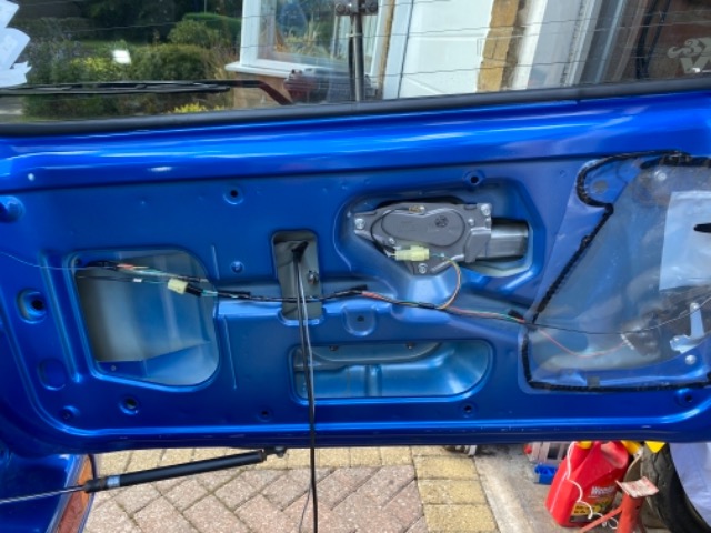

I have the coax to route, I will drill the rear door, pass it through and next to the door wiring, then through the cab to the dash. I will have to cut the plug off to do it and solder a new one on.

That's a tidy little use of space. For my install, I managed to feed the RF cable through the same place as the rear door wiring loom. I just cut a slit in the rubber to aid passing through and didn't need to drill anything. Bit of WD40 always helps sliding through. Then once it was through, I just put a bit of electrical tape round the rubber to seal it up again.

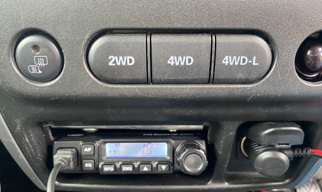

I fit mine below the ashtray.
Not so easy too see the display there, so better to put it higher.

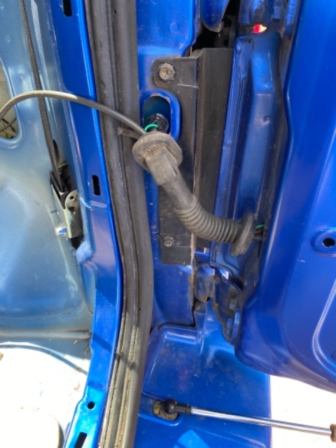

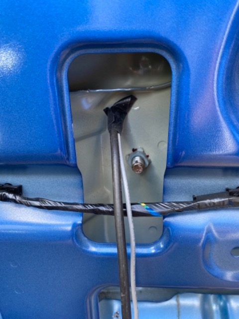

I wanted the coax hidden so did drill the rear door near to the spare wheel mount. Note the tape over the car plugs. PL-259 plugs don’t seal so fill up with water after a period of time.
Then sealed it up with some rubber tape. The cables came through quite easy.
I then fed the coax next to the door wiring and through the rubber cable duct.

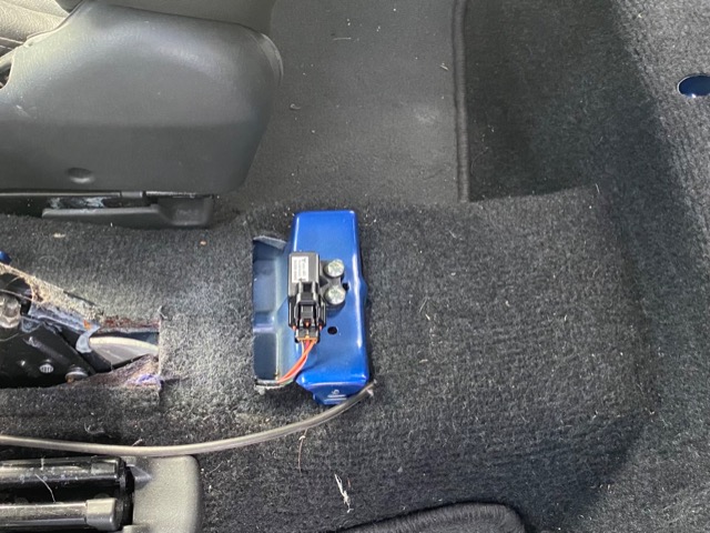

The coax was then passed through the side panel, then under the seat and carpet next to the drive tunnel, under the hand brake cover and along the side of the gear stick cover to the radio.
Routing the coax this way means it is hidden from view so won’t become caught or damaged. It did involve removing a few panels, but these seem to come off I need a fairly regular basis on my Jimny.
