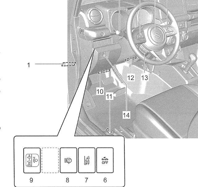

It should be possible to diagnose if it is, such as be further away from the road edge or see if it happens in both directions.
Also, do you have buttons 6 & 7? Might be worth turning them off one at a time and seeing if it changes the results.

Button 7, the lane departure warning can be switched off permanently.
Button 6, The dual sensor brake support can be deactivated each time you start up but reverts to off when you switch off.
Roger
