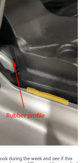

Just checking my email and I have had a reply from Bravo Snorkels.
This is what they have said:
We already sold more than 1000 kits of the new Suzuki Jimny snorkel, and we have been informed only from 1 customer of a similar issue. See attached photo, he told us that installed a rubber profile between the snorkel and the metal zone and the problem was solved.
It's really strange that this happened, we did lots of several tests with 2 different Suzuki Jimny's during the development and the first snorkel kits produced, no issue happened. We think that this may be because the final position of the snorkel installed can vary depending on the adjustment of the metal brackets and bolts to the vehicle fender and body, and also about the hole drilling position for the rivnut. Did you try to dismount the snorkel, and adjust the brackets and bolts to a different position? Probably with the snorkel placed in a slightly different position, the vibration will disappear.
If this happens to more customers, we will develop a solution consisting in a rubber part to be installed somewhere and give more consistency to the snorkel once installed. It was a hard job to develop this kit and we did the best possible for the interior and giving the proper room and respecting/increasing the original airflow to increase the performance. We don't want a vibration to ruin a customer's experience.
Please make this test of changing the position of the snorkel, and send us a video if the problem persists, so this way we can better understand and look for a proper solution.
I'll have a look during the week and see if this suggestion makes any difference. I have replied to Bravo Snorkels and pointed to this thread.

16 Jan 2023 09:03 - 16 Jan 2023 09:05 #246941 by Soeley
Replied by Soeley on topic New Gen4 Snorkel
I have just received my reply from Bravo. I am impressed with the speed of the reply.
Dear Mark,Thanks for your email and feedback. Right last week we were informed by another customer of this same problem, but we have only had this case from the UK and also another from another customer... so you're the third case. This other customer informed us that he solved it by just including a rubber profile between the snorkel and the base of the hood's hinge, see attached photo. He didn't find a vibration itself in the snorkel, but adding this rubber the problem disappeared. Maybe you can try something similar to see what's about the problem?
With the other customer from the UK we're checking if the problem it's different and may come from the lack of the original resonance box, which we are trying to find out and give a solution. Just for your information, the flex pipe is a temporary solution until we get the final EPDM ducts that we're developing after having checked the models LHD, RHD, and other versions with different engines and configurations on sale all over the world. It's a slow process and we expect to have the final hoses ready within April. So we could add in these hoses the opening to connect the original resonance box if it's needed, we will make tests with this customer with a 3D printed version of the hose to make the verifications.
Also, in case that we find that the snorkel just needs a rubber profile, we will develop it and send it by warranty to the customers that already have the snorkels, we guess is just probably because of it, but anyway the EPDM hose solution could also solve it.
Please do the test with the rubber and let us know, we will follow this matter to find an immediate solution that could be offered to customers asap.
