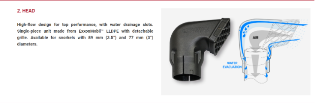

I knew I'd seen this somewhere, just found it. Looks like by design, the water should get expelled at the head.
03 Dec 2022 14:47 - 03 Dec 2022 14:48 #246214
Replied by mlines on topic Re:New Gen4 Snorkel
Some have a water trap built into the head, the Brazilian ones have a one way valve at the base and some rely on the drain in the air filter case. Just wondered what they had.

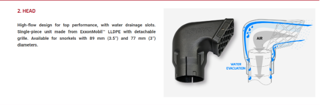

When will you be fitting it? Are you going to do the install yourself?I knew I'd seen this somewhere, just found it. Looks like by design, the water should get expelled at the head.

I don't have a snorkel on my Jimny, but I did fit one to my GV, and rather than block the hole in the filter box, I drilled it out and fitted a small duckbill valve - it's essentially a one piece flexible silicone one way valve.
Replied by fordem on topic Re:New Gen4 Snorkel
The instructions do not mention anything about plugging the drain hole in the filter box, so they must be relying on that.

That sounds a neat idea
