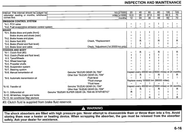

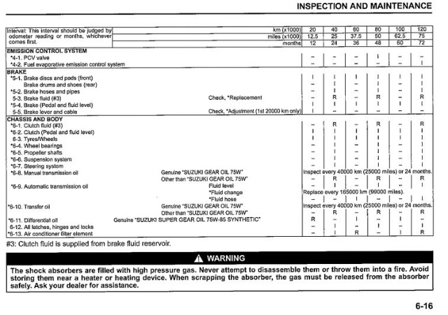

24 Feb 2021 13:36 - 24 Feb 2021 13:43 #233213
by Gadget
Replied by Gadget on topic Gen 4 service cost
Last edit: 24 Feb 2021 13:43 by Gadget.
