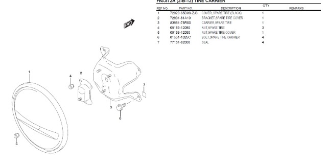

Have you checked the tightness if the spare wheel nuts to make sure it is held securely? if they are tight, remove the spare wheel and check the wheel mount itself is secured properly.

Have you tried thin rubber washers behind the spare wheel mount between the mount and the door? THere were some made at some point without 77151-82000 seal in place
