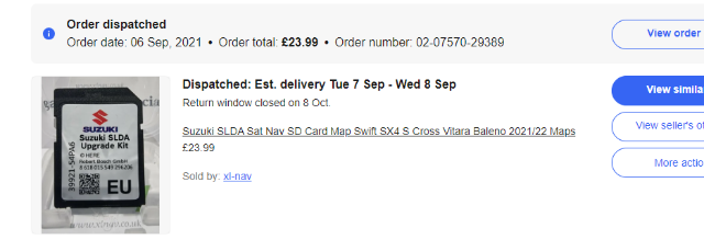

This is the one I bought
I cannot find the radio at the moment (I took it out as I could not get the touch screen to be reliable)
The units are basically all the same in the E02/E22 area (Ignis/Swift/Jimny). I did the 1880 update (I think there is an 1890 update now)
Replied by mlines on topic Gen 4 radio software update
