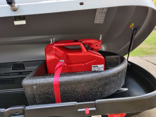

21 Aug 2020 16:54 - 21 Aug 2020 16:55 #227096
by Gadget
Replied by Gadget on topic Re:Carrying additional fuel
Think I've got a solution. Ideally I wouldn't take my roofbox, but it'll be really handy as somewhere to chuck a wet tent when I'm breaking camp, so no real hardship.
Had a spare wheel-well insert from an old car - cut a jerry-can sized hole in the middle and voila, I can secure the can right over the strongest part of the roofbox floor and it physically cannot fall over, even without the retaining strap. I get to carry extra fuel, it's in a ventilated space, it's not in the car and it's secure, think that covers all the worries?
Will probably edge over the 30kg roof limit - bars are 6kg, roofbox 16kg, can 3kg, so leaves me 7kg for the petrol itself - although with 30kg of rocksliders hanging under the chassis, I don't think it'll really make much difference to my centre of gravity! :lol:
Edit: the bits of bluetack on top of the can are my sophisticated clearance measuring devices :silly:
