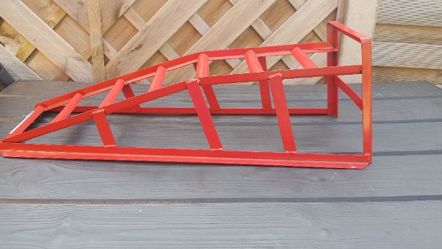

It took me ages to choose the right axle stands and wheel ramps.

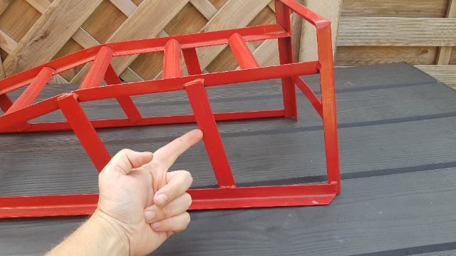

Some wheel ramps looked pretty lame, with no cross bar where it mattered (under the wheel). The cheapo ones all had no extra bar, so i went with these.
These have this extra support bar

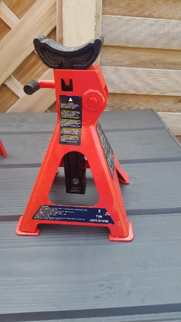

The axle stands were middle of the road ones, but have decent welding and rated for 3t per stand.
Buy the best you can afford obviously.
I still get anxious underneath though, and place huge blocks of wood under the arm gaurds just incase of axle or wheel stand failure.
