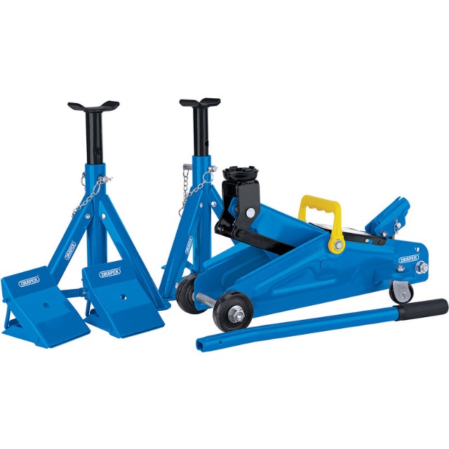

1. www.toolstation.com/draper-trolley-jack-combination-kit/p99344

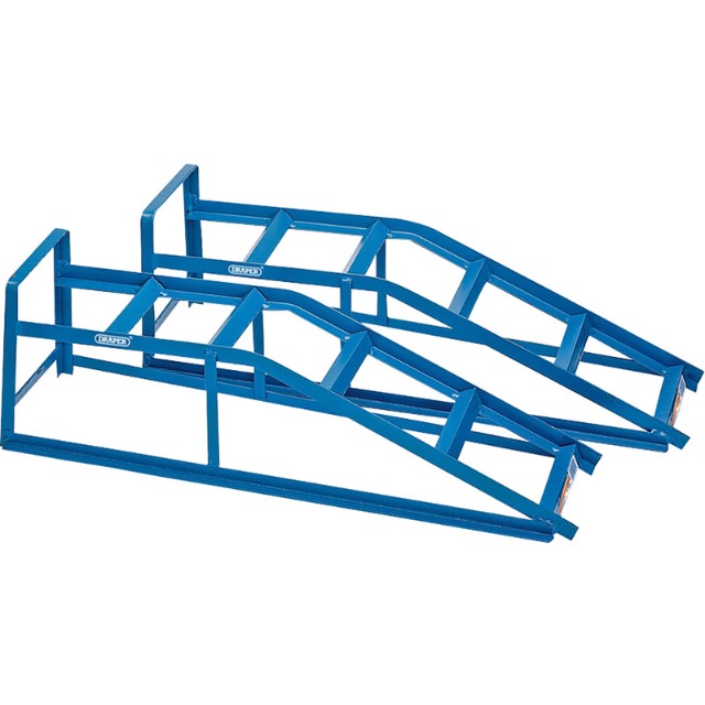

2. www.toolstation.com/draper-car-ramps/p21734
Considering the potential risks I thought I would ask for advice on here.
Would you recommend ramps or jacks?
Or is there a better and safer solution?
Any specific brands and models to go for? Or to avoid?
I am a beginner and I am unlikely to do anything too complicated mechanically... Perhaps top up the underbody seal coating protection, more guards, etc. Many thanks for your help.

I have both ramps, trolley jack and axle stands, It depends on the job in hand. If you require a wheel off then a ramp is no good. Seeing as you are just starting out and want to fit JBs gaurds i.e. Transfer Box, Fuel Filter and Rock Sliders then the ramps will do for those. You can always add to your collection later on.

NEVER WORK UNDER A CAR SUPPORTED PURELY BY A JACK.
The ramps are simple, foolproof and practical but never use them on gravel or grass etc. For safety use them on a level hard base such as tarmac or concrete. Always use chocks.
A jack is used for changing wheels etc but remember to chock at least 2 wheels and if you need to venture under the car use axle stands which
, by the way ,can be used under the chassis rails

I have been using Jack stands and ramps for years. Helped me a lot. The Jack in the picture does not look Great though.. Check lifting height and size. A Jack with a larger footprint and higher lift will be more stable and useful. I had only a Jack like the picture for years and it did help me get by when on a budget.

The ramps are great for a quick check underneath, also ok for fitting guards one end at a time.
I use two sets of ramps for service work simply as the vehicle is raised but level, perfect for oil changes etc.

That's pretty much the order of preference, I feel safer under a vehicle on ramps with the wheels on (chocked), stands second and never under on a jack.
