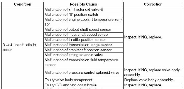

Hope that is all it is. I should have confirmed that you didn't get a light signaling a fault. If you do, you should probably have it checked for a fault code. I've never had a problem with the auto on my Jimny but I think the TCM will signal the ECU and you will get a fault code.
With a code, you may find one of theses is at fault:

Just got home and tried what you said but doesn't seem to be engaging that overdrive still, I forgot to add my engine management light is present, we've used our diagnostic reader and its showing 'undocumented code - P188700' I can only assume its possibly one of the above throwing up the code.. can't really find anything online that will tell me what causes the code!
