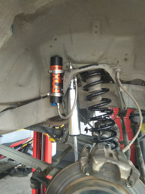

I would have replied to Keithy's post in another thread yesterday but was busy doing this:

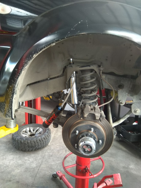

Initial test fit with the elbow installed so that the hose would be directed downward.
Reservoir mounted

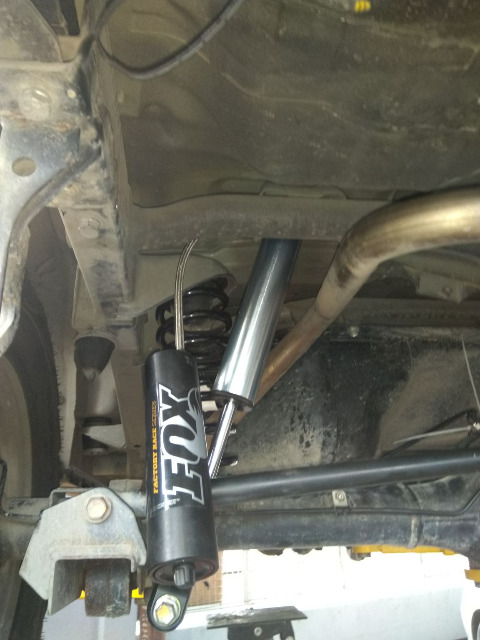

Rear started. Went to a nearby mall for lunch so didn't take final pictures of those. Will add them when I finally update my build thread.

When the Fox rep installed the elbows, he suggested that, rather than going directly to the standard 200 psi on reassembly, that I start at 150 psi and then decide what I wanted. After driving for a while, I will also decide if I want to do any revalving.
