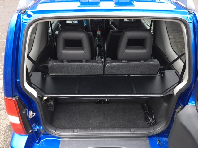

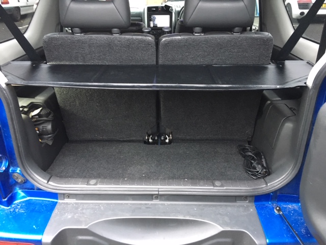

The finished article fitted in my 2011 SZ3

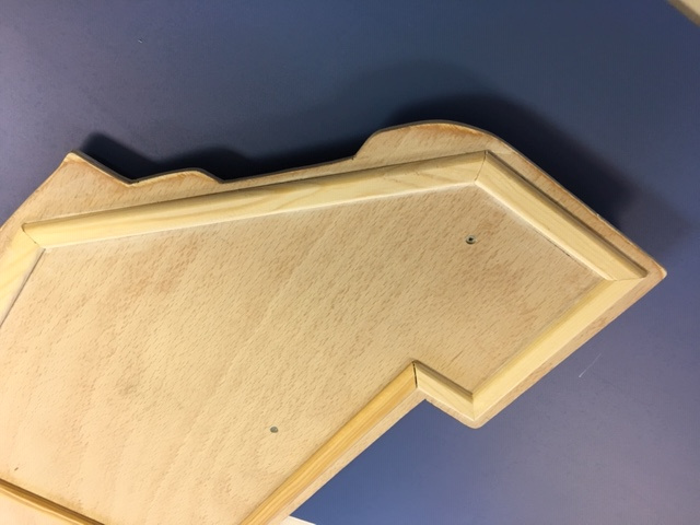

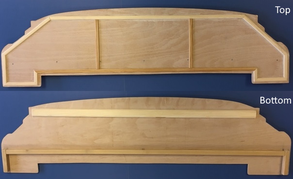

It is made from 5mm plywood with curved wood trim to the top, thicker to the bottom and a strengthening wood stringer

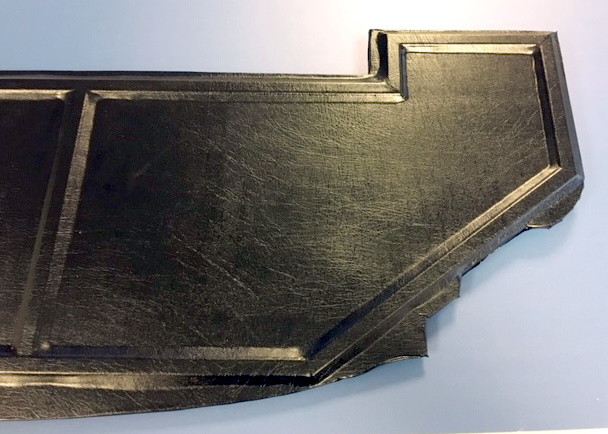

Close up of the edge. The wood strips on the top stop items moving
Then it is wrapped in a leather grain vinyl wrap (from B&Q) with a few bits of foam on the bearing points.
Total cost plywood £13.40 and wood trim ~£6 (Wickes), wrap £5 (B&Q), the foam I had. It took me quite a while to make, cutting out, glue, but the wrap took almost the longest and needed a gentle heat gun to get it to sit round the corners.
