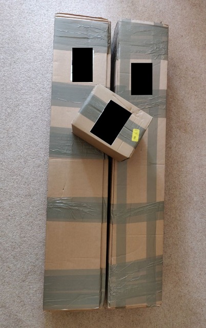

Supplied in three boxes, labelled left rail, right rail and fittings.

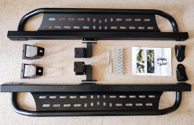

Brackets don't come attached. Supplied with all hardware needed and colour instruction sheet.

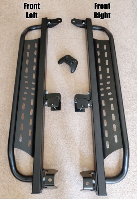

Brackets installed (need to be removed before install) with Xbox controller for an idea of size. They're big.

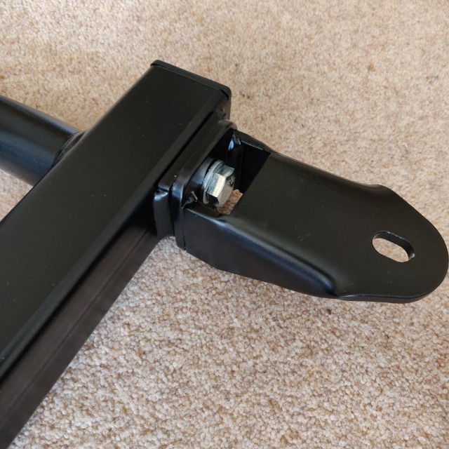

Front bracket. Re-uses existing body mount bolt to attach.

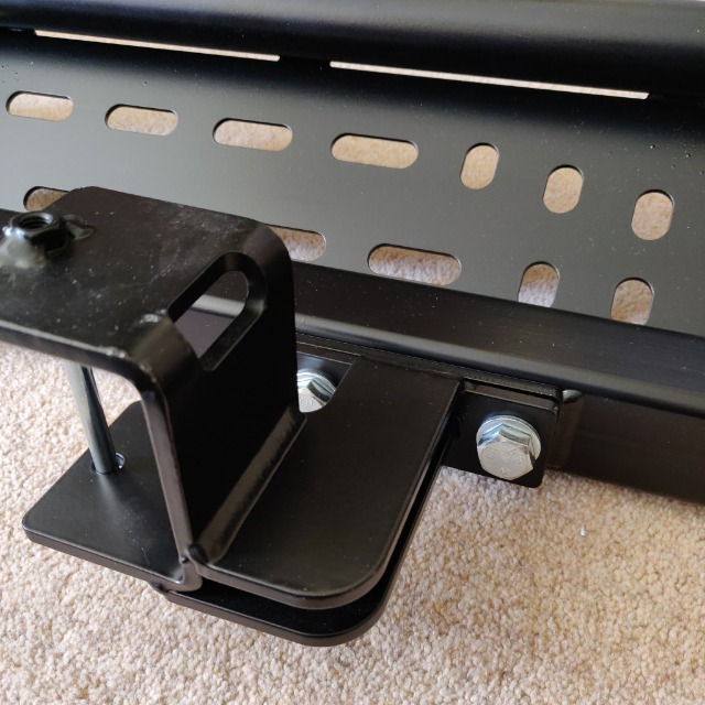

Middle bracket, bolts through the odd tube section on the side of the chassis.

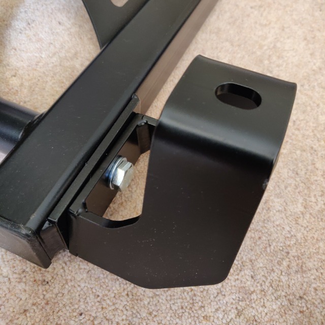

Rear bracket. Re-uses existing body mount bolt to attach.
Build quality seems exceptionally good. Very thick metal, neat welds and nice powder coating (a couple of minor scuffs from transit).
