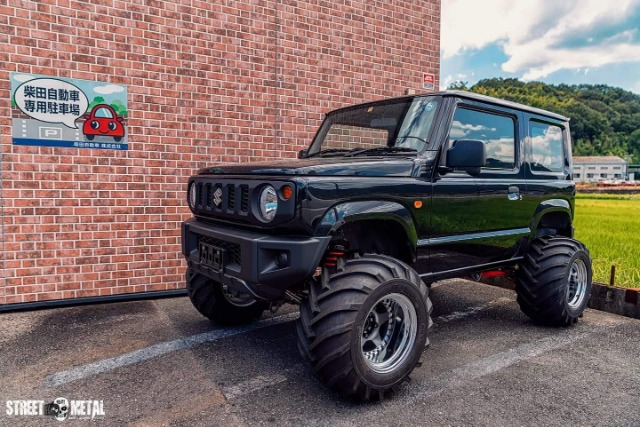

I didnt build my Jimny originally, it was already in the basic form that you see it. I have replaced or improved parts where the originals have failed or were poor quality. Therefore it came with a 3" lift and still has one although I replaced it with far better springs and shocks. The problem is the slippery slope of modification, once you start....
Larger tyres >> Lift Kit >> Gearing correction >> castor correction >> increased bearing wear etc. etc.
Dont get me wrong, I love the look of mine. but it is more look than practical. You see a lot like mine at events and they mistake true capability for kinetic energy. A truly capable truck will crawl over an obstacle without the wheels spinning ie. its got the grip, low down power and flex. Instead you will see the Jimny hurled at the obstacle with the engine screaming and wheels spinning using kinetic energy rather than skill or capability. If you were to fire a concrete block at a hill fast enough it would go up it
So with our Gen4 it will get mud tyres and a 2" lift to give the muds a tiny bit more room and that is it. I fully expect to see it happily following BigJimny around and half expect to see a picture of it pulling BigJimny out after BigJimny blowing a CV joint due to the large tyres and red mist
As an example, I bet this owner is please with the look but not as pleased as his CV joint and bearing supplier
